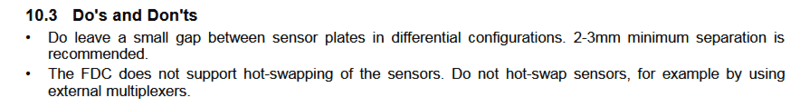

I am trying to control a massive amount of electrodes (position-fixed leads of a capacitance sensor FDC2214 for imaging, more electrodes means higher resolution). The control here is merely a "connected/disconnected" from each electrode to FDC2214. What kind of relay or switch is not yet decided. The power supply will be a 5V DC from an AVR MCU.
From the relevant datasheet:
I won't say that it is impossible to make it work, but usually it requires a deep understanding of the circuit to go against the factory recommendations. I suggest to check for alternative solutions.
Also, worth checking the PCB layout recommendations. They are not there to be taken as a joke!
Thank you for the advice. I always have a backup plan of moving the sensor by servomotor to sweep over the sample if "sensor array" is a dead-end.
