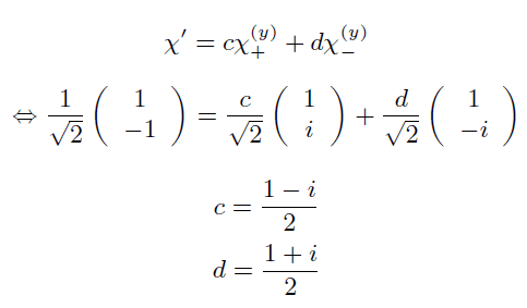

See attached image.
I get a different solution: First multiply by \sqrt{2}, then {1 \choose -1} = {c + d \choose ci - di}. So we get c + d = 1 and so (1 - d)i - di = -1. Solving the last one gives 2di = 1 + i, so d = \frac{1 + i}{2i} = \frac{1 + i}{2i}\frac{i}{i} = \frac{i - 1}{-2} = \frac{1 - i}{2}. But that's the answer for c. Where does my solution go wrong?
The book is wrong. You can see this by substituting their "solution" into the original equation.
