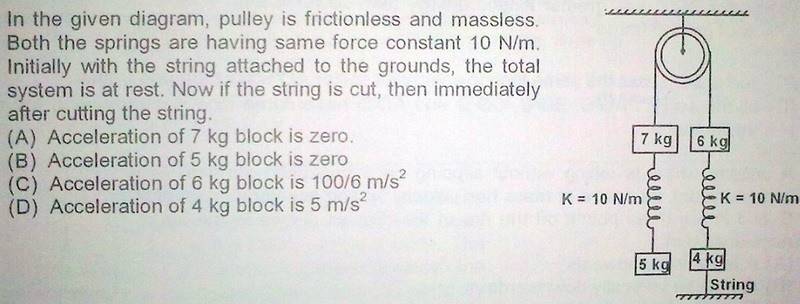

cupid.callin Messages 1,130 Reaction score 1 Thread starter Mar 25, 2011 #1 Homework Statement The Attempt at a Solution I could say that (A)(B) are correct and (C) is wrong and i know 4kg block will have acceleration but i don't know how to find it. Attachments AITS (1).jpg 35.6 KB · Views: 468
Doc Al Mentor Messages 45,589 Reaction score 2,484 Mar 25, 2011 #2 Hint: What's the tension in the spring connected to the 4kg block?
