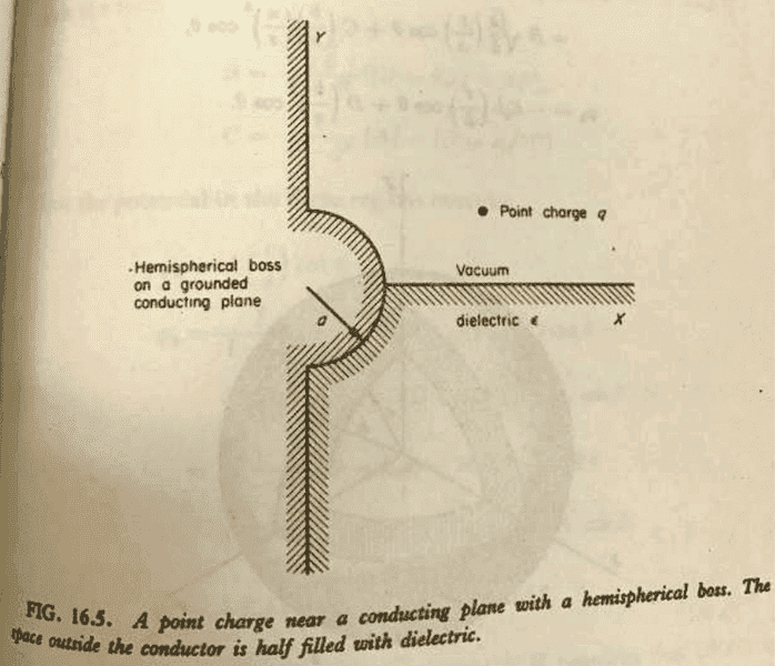

What collection of image charges solves the problem in above pictured ??
One of the image charge should be in dielectric region
q'=-((e2-e1)/(e2+e1))
What book has this problem, it is a good one...this one will take some time to figure out.
I see 7 image charges in this one and they are not trivial to calculate...
