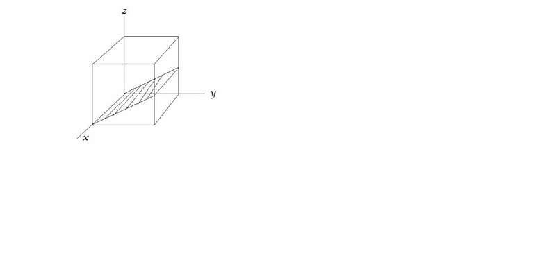

Hi Guys,
What are the milled indices of plane (see attached figure). Its very interesting...and I am receiving every-time different answer from others.
Have a look.
Shriphy
Remember you can put the origin at any lattice point.
Bravo Johng23,
Your answer is perfect...I was checking all suggestion by inserting values on the link http://www.doitpoms.ac.uk/tlplib/miller_indices/lattice_draw.php
but no value was leading for this plane except yours.
But still I can't say that I got it 100%. Here x intercept is 1, y intercept is 0 and z is 1/2. So according to definition Miller indices should be reduced reciprocal of intercept...then what about x intercept...which should not be 0??
correct me please
Hi Johng23,
I got that if we consider origin at b=1 on given y-axis point then indices are as you said...but if we consider origin at some other points (suppose a=1 on x axis) then answer will be different. Kindly is there any idea rule to consider origin??
In any case thanks for your consideration.
shriphy
Shriphy
It the plane goes through the origin, every intercept is zero. That's not very helpful in determining which plane it is. As long as the origin is not lying in the plane you should be fine.
