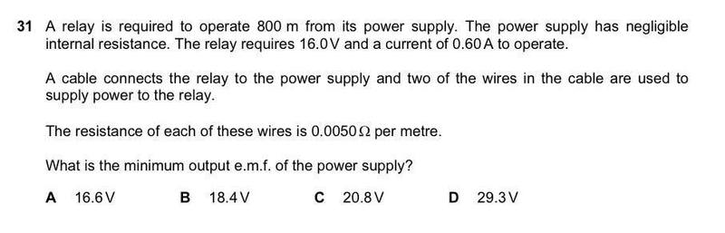

Multiple-choice physics question 31: relay 800 m from supply needing 16.0 V and 0.60 A; cable wire resistance 0.0050 Ω per metre; options A 16.6 V, B 18.4 V, C 20.8 V, D 29.3 V.
V=IR
For resistors connected in parallel, 1/R =1/R1 + 1/R2 +...
I first calculated the resistance of the the cable which consists of two wires,
1/R= 1/0.0050 + 1/0.0050
R = 2.5x10^-3 x 800
= 2 Ω
Then I calculate the voltage across the cable, V=0.060x2= 0.12V
So the total p.d would be 0.12V+16.0V=16.12V, and I chose A, but the correct answer is C. Why?
Please help, thanks

One of the wires in the cable carries current toward the relay and one carries the current back toward the power supply, right? If you drew that as a circuit diagram, would that makes those wires parallel or series?
Oh right! It's series. I misread the question. I've figured out the answer already. Thank you!
