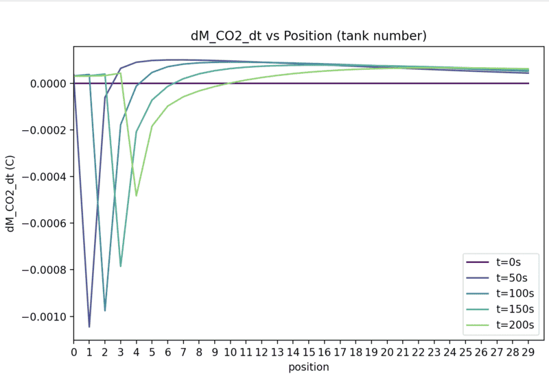

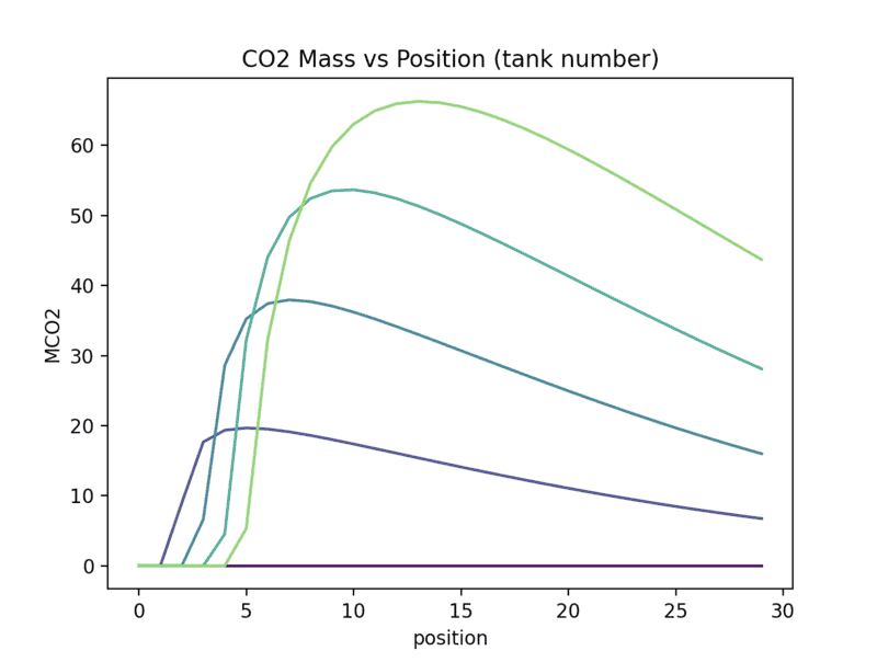

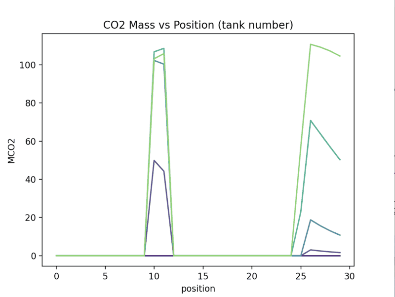

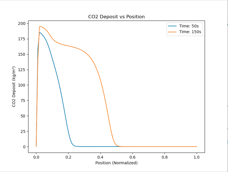

casualguitar said:
k/30:

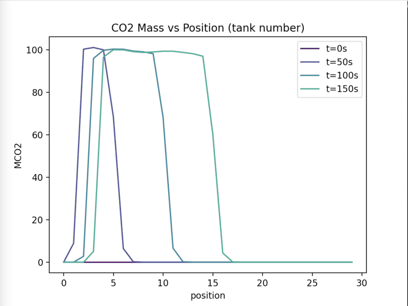

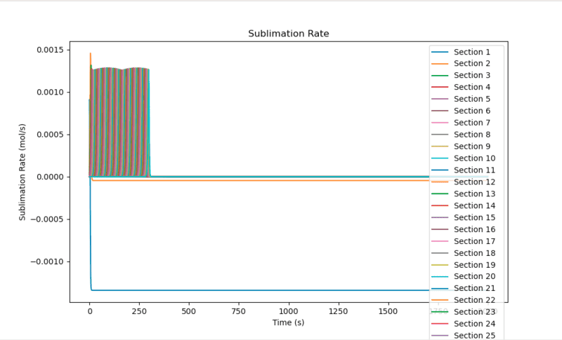

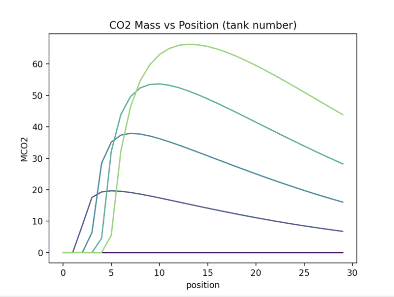

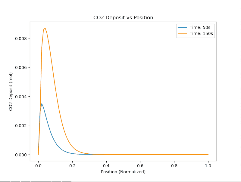

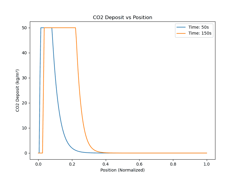

Here is a plot of the rate of desublimation of CO2 for the same selection of times:
The MCO2 plot seems to suggest that there are two plugs of CO2 moving through the bed rather than one. However the dM_CO2_dt plot doesn't suggest this
So what is your interpretation of what is happening here?
Please provide a documentation of the finite difference equations for heat and mass transfer that are currently being used in the model.

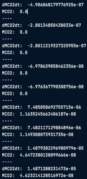

  • #302

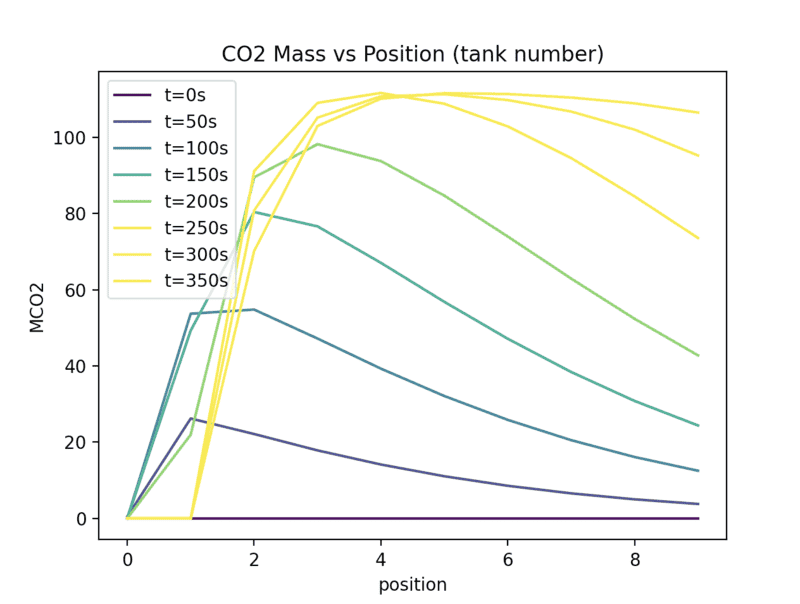

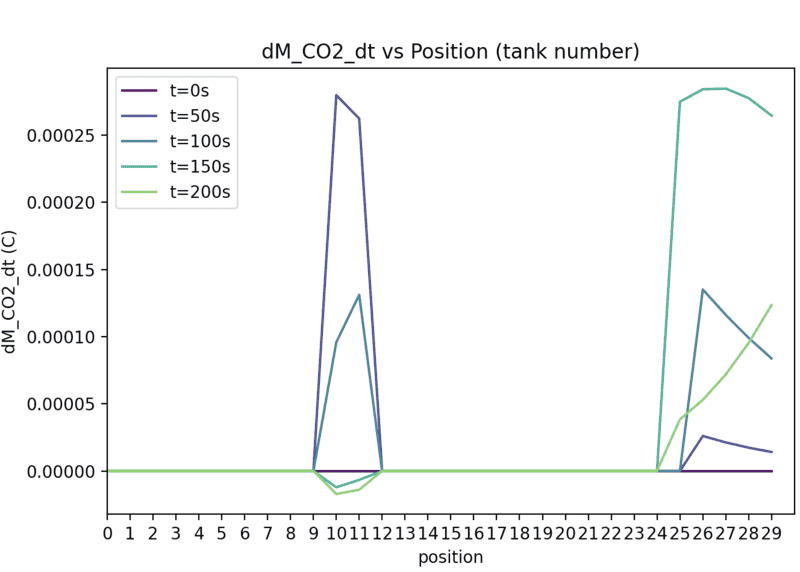

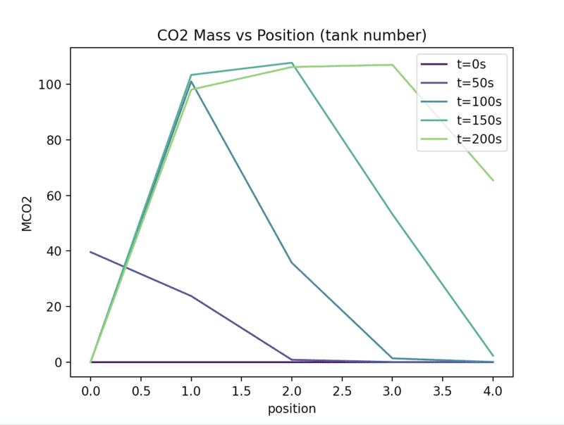

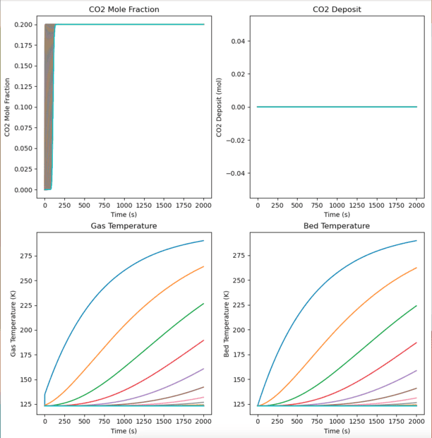

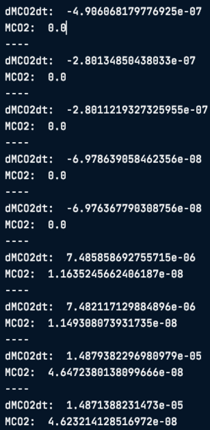

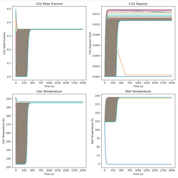

I had turned both the MCO2 value and the dM_CO2_dt values to zero in the case where the solid buildup goes below zero, but really its just the MCO2 value that needs to be zero I think
Changing this (so now in the case of negative solid buildup the value is set to zero), here is the output for k/30:

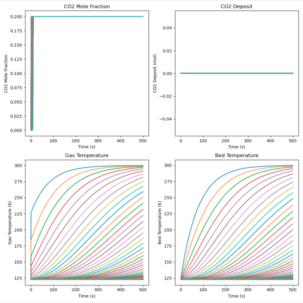

Just checking some more ki/x values now to try the solid deposition to peak at a similar value to Tuinier et al

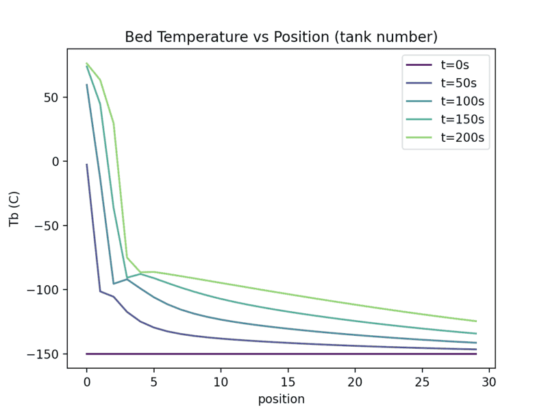

  • #303

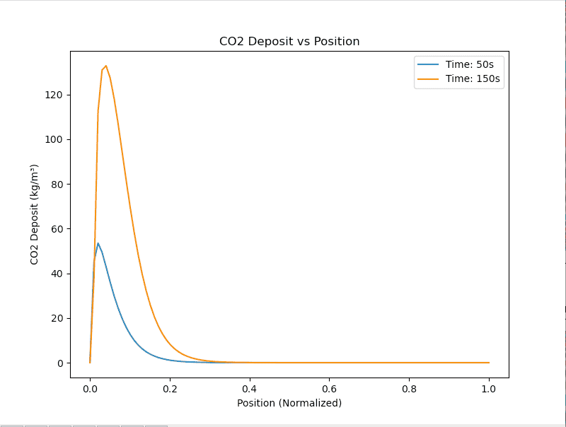

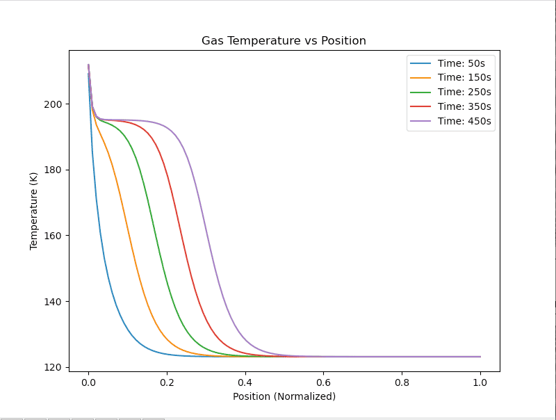

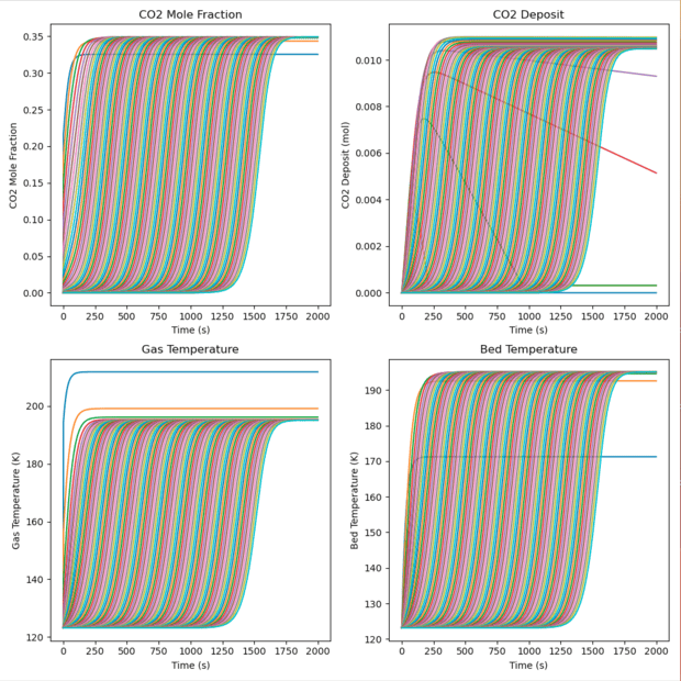

After turning off the if statement that forced the rate of sublimation to be zero the plots look fairly close to Tuinier et al with some differences (k/100):

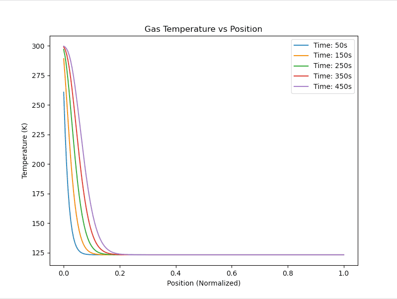

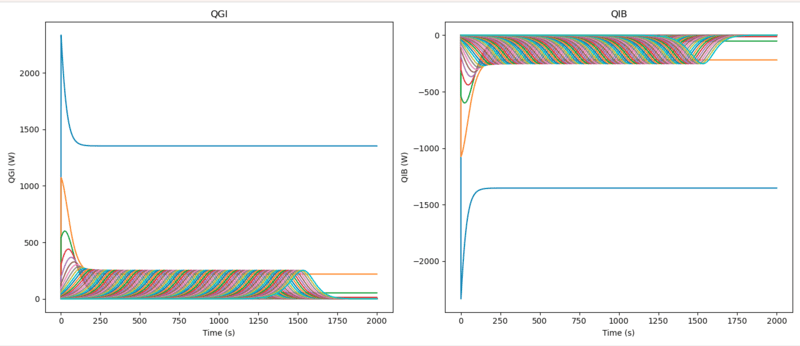

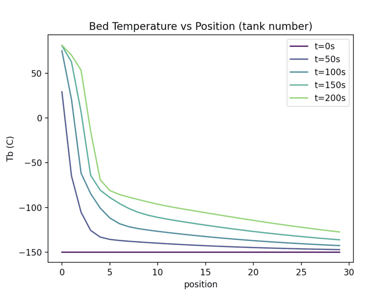

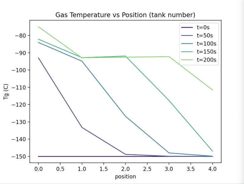

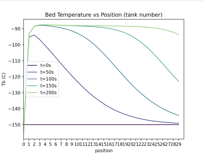

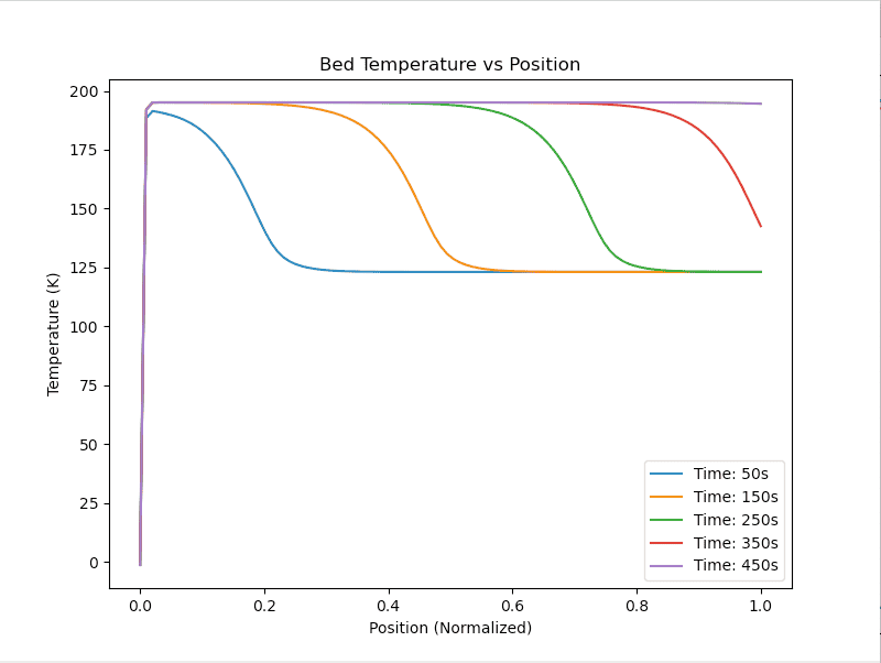

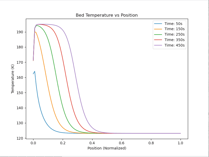

Adjusting the heat transfer coefficients:
If Ug and Ub are both = 100000 we get the plot below for Tb (I think very high Ub and Ug approximates the Tg=Tb assumption made in the Tuinier model?):
And here's Ub = 100000 and Ug = between 20 and 50 (calculated for each tank):
For the MCO2 plot, is their 'fudge factor' as you previously called it coming into play here? The max solid deposited seems to be in the ballpark of the Tuinier model, however our rate of sublimation of this solid seems to be a lot lower (their peaks are sharper).
Lastly, when Ug is not a very large number the constant temperature zone seems to appear for Tb, but not for Tg just yet
  • #304

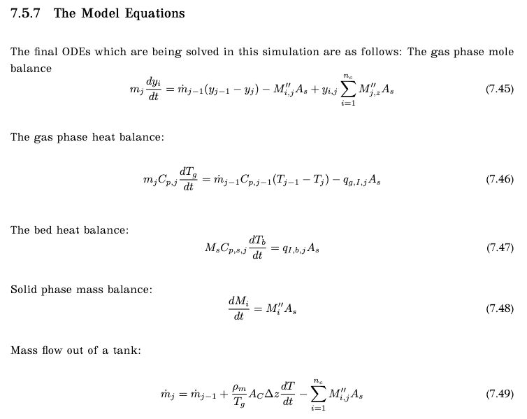

Refresh my memory. What do you use for Ub in the standard situation, and show its calculation.
  • #305
Apologies for the delay (public holiday here) -
##U_b## is calculated by:
$$U_b = \frac{k_p}{\frac{d_p}{\beta}}$$
where ##k_p## = 0.8W/m., ##d_p## is 0.00404m and ##\beta## = 10
Using the above values, ##U_b## = 1980 w/m2.K
I checked the ##k_p## value (ranged it from 0.1 to 50) and changing the value of ##k_p## does not seem to affect the plots visually

  • #307
Chestermiller said:
Looks good.

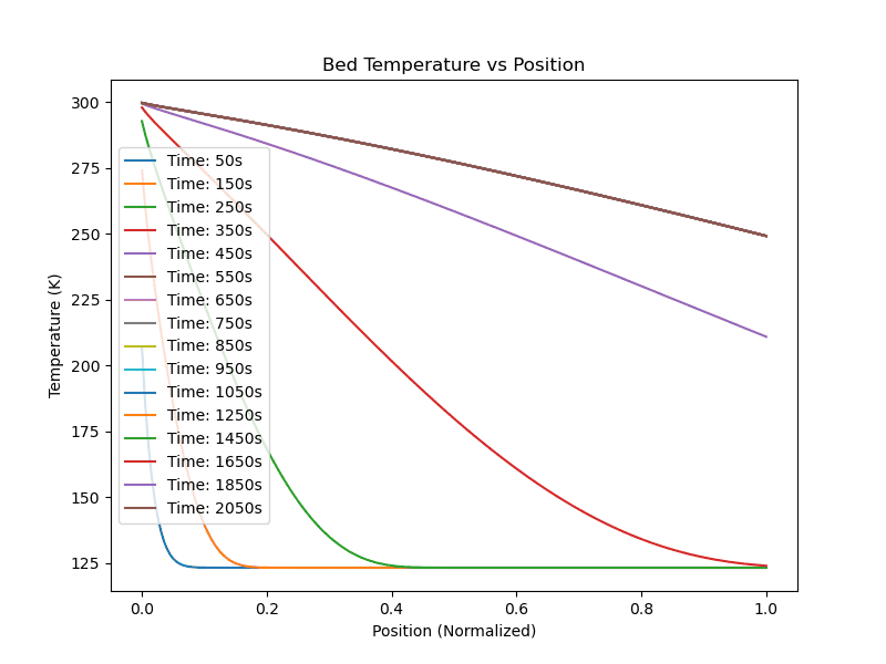

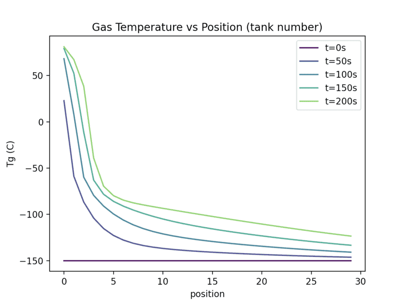

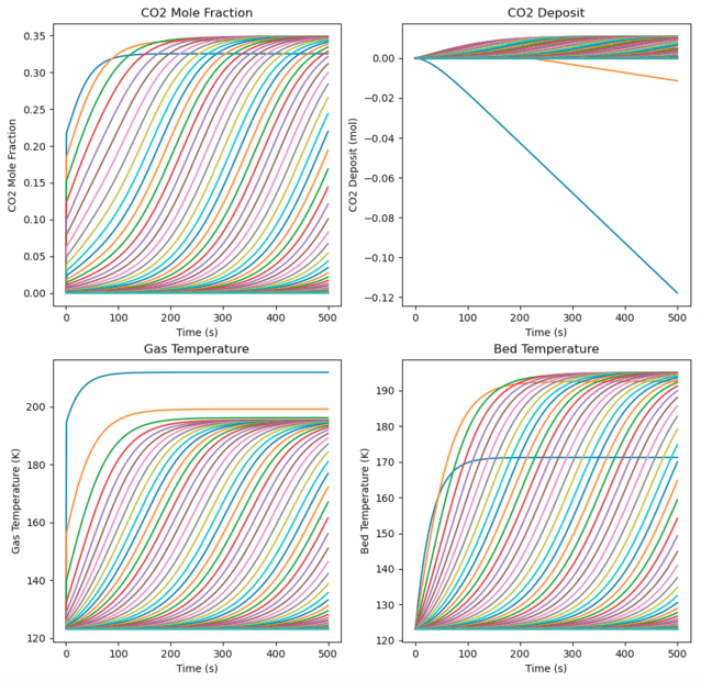

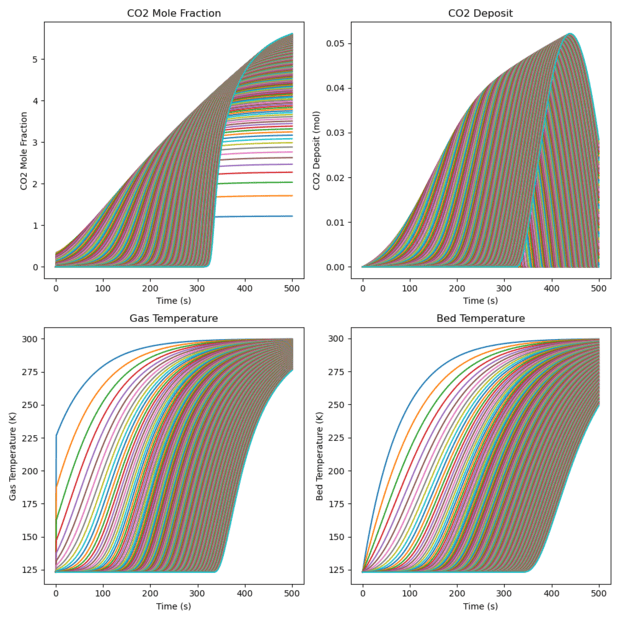

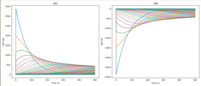

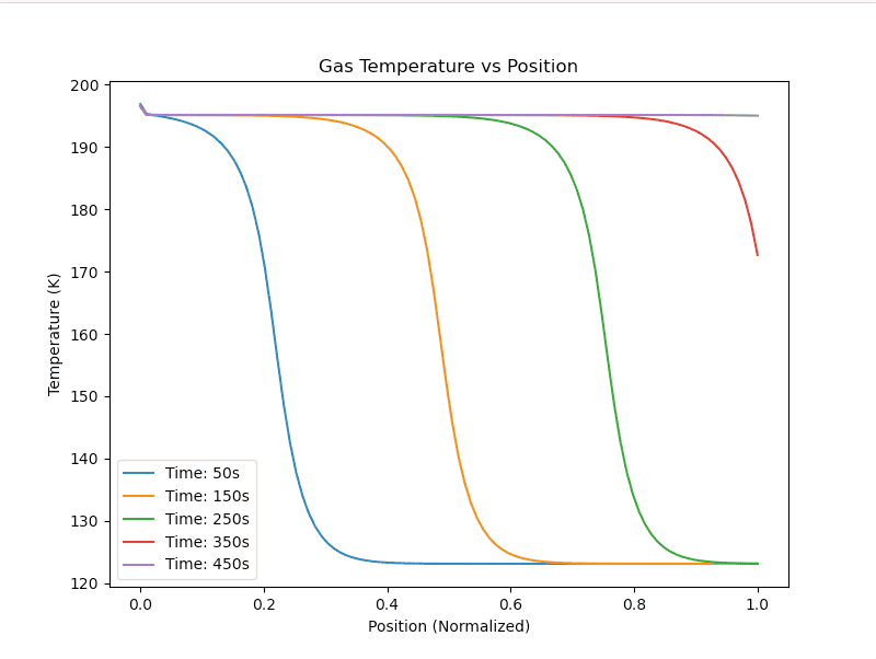

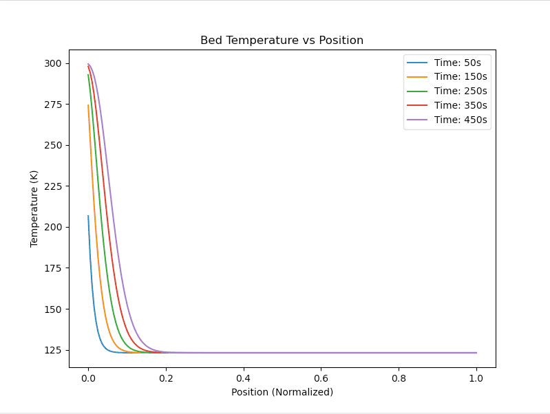

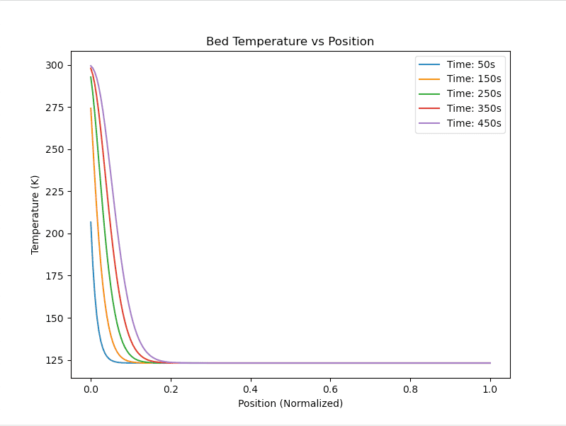

Here is the output for ##U_b## calculated as above, and ##U_g## calculated at each interval

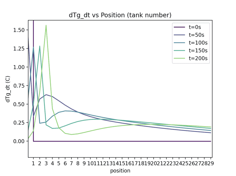

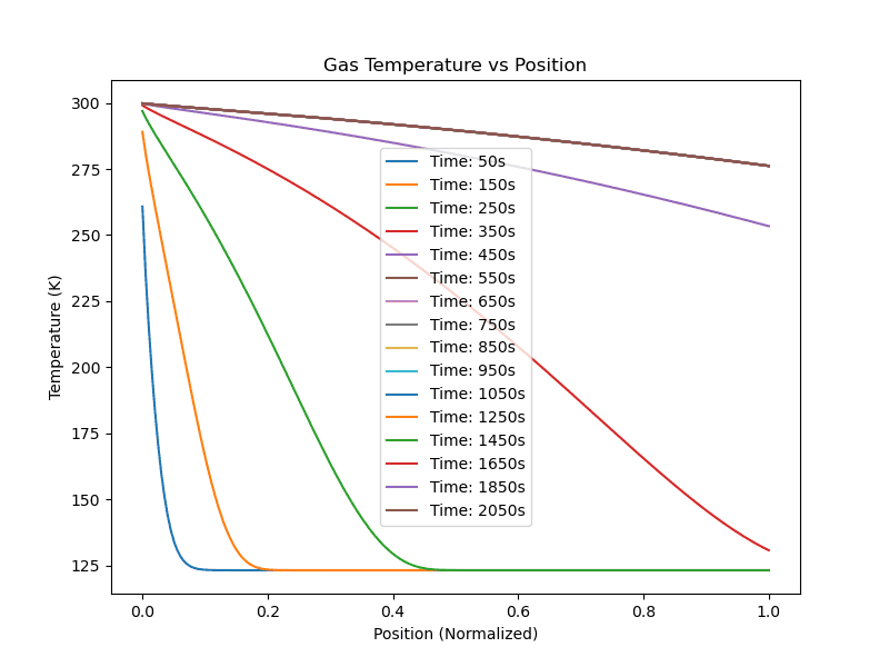

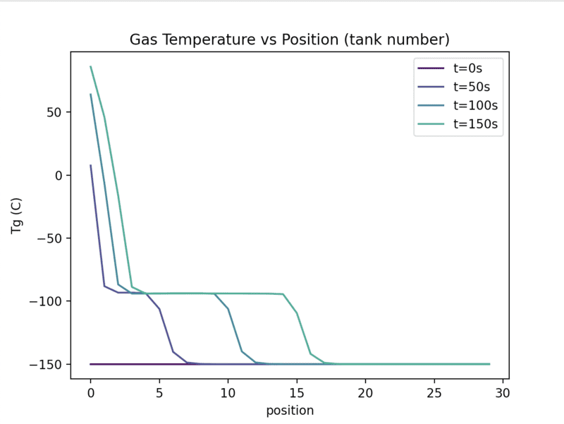

I think generally the output above is similar to the Tuinier output. The main two differences seem to be:
1) the rate of sublimation of the solid buildup (solid to gas) is lower in our model (gradually tails off rather than immediately sublimates
2) there is no constant temperature gas section showing up in our model
Checking the dTg_dt plot shows that there is no section where the value of dTg_dt reaches zero (a constant temperature section):
In the Tuinier model, what is the driving force that actually keeps the gas temperature almost constant while the phase is changing?
Is it correct to say that these results were obtained using the corrected mass transfer description together with all other parameters standard?
I think the difference is that we have heat transfer resistance between the gas and bed and a different mass transfer parameterization (and different dispersion parameterization). We can make our results more like theirs by increasing Ug (I think). You can see that the bed temperature is closer to constant than the gas temperature at -90.
We can also decrease the dispersion by adding more tanks, holding the length of the column constant.
Yes these results were obtained using the Tuinier dimensions, flow and initial conditions as much as possible, with the corrected mass transfer coefficients of ##k_{CO_2}##/100 and ##k_{H_2O}##/100. The ##U_b## value is calculated according to the equation in post 305, and the##U_g## value is calculated using the correlations from BSL

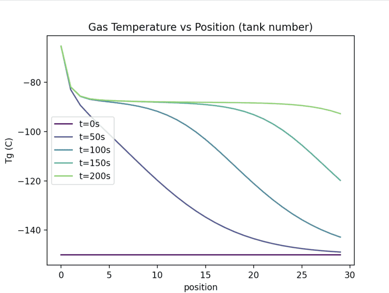

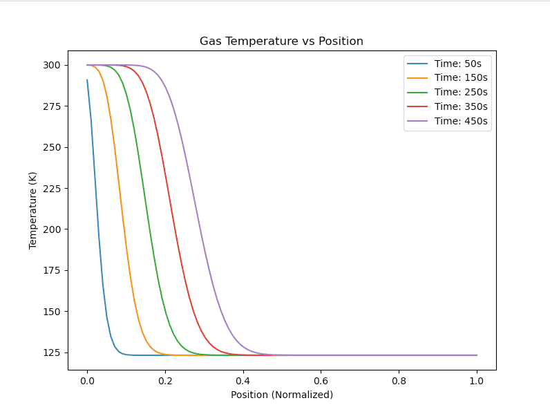

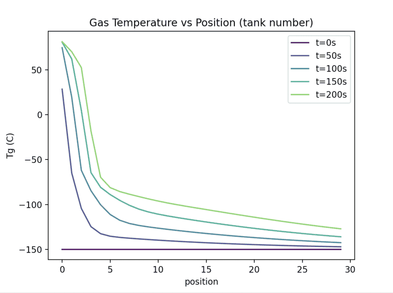

Ok I see what you're saying. If we increase ##U_g## then the gas temperature will more closely follow the bed temperature. Checking a value of ##U_g##= 100000 gives this ##T_g## profile which is visually identical to the ##T_b## profile:
As a note, if I calculate the ##U_g## values at each interval (which gives a range of about 20-50W/m2.K), then ##T_b## starts to show the almost constant temperature section, which doesn't happen at high ##U_g## values. The ##T_g## profile is unchanged from the one above:
Running the opposite (calculated ##U_g## and a high ##U_b## value gives identical output to the ##T_b## and ##T_g## profiles above)

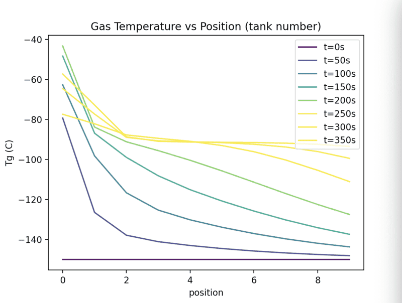

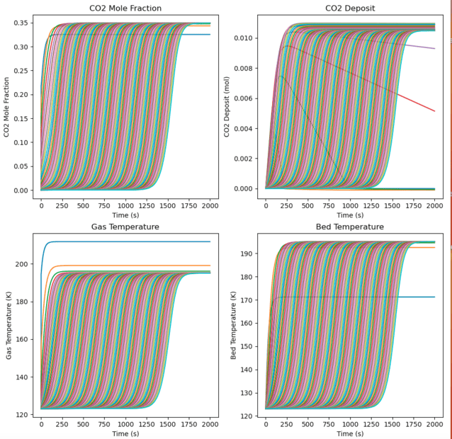

Checking n=100 now for calculated ##U_g## and calculated ##U_b## values (no very high values). This will take a fair while to run so I'll post these results once it finishes
Is this considered 'model tuned'? I guess this is a judgement call rather than anything but it seems pretty close. If this is 'model tuned' I was thinking about taking what was learned during debugging here and applying it to the original liquefaction model (I'm guessing I can find some bugs in that now, and the model is simpler in comparison)
But besides this, I was thinking about some other things. The Tuinier paper (in my view) isn't that useful for a new reader because it doesn't actually say how good the system is (or can be), but rather just shows output for the system they used. What I mean is that they don't define performance parameters that would allow someone to compare this system with others or get a feel for how good this system actually is
To do something like this would involve (I think) answering questions like "what performance parameters are actually useful to calculate here?", "what simulations best show how these performance parameters vary with varied input" and lastly "does the model need to be developed further to be 'different enough' from the Tuinier model". Or something like these anyway
Regarding the performance parameters, I guess there are standard ones. However, possibly one meaningful parameter is the separation efficiency (how good can the system get at separating CO2 from both N2 and H2O in theory).
And lastly one other thing Tuinier didn't do is vary the ICs/BCs to arrive at an optimal solution (optimising the performance parameters). This sounds interesting to do and would also be novel as far as I can see (just trying to think of ways to further separate this model from Tuinier and make it of use to a future reader)

So you used our k divided by 100. Please double check the finite difference equation used in our model for the mass flux from gas to solid to make sure we are not missing something (like say a factor of ##\Delta z##).
casualguitar said:
Ok I see what you're saying. If we increase ##U_g## then the gas temperature will more closely follow the bed temperature. Checking a value of ##U_g##= 100000 gives this ##T_g## profile which is visually identical to the ##T_b## profile:View attachment 305285
Running the opposite (calculated ##U_g## and a high ##U_b## value gives identical output to the ##T_b## and ##T_g## profiles above)Checking n=100 now for calculated ##U_g## and calculated ##U_b## values (no very high values). This will take a fair while to run so I'll post these results once it finishes
Model tuning is when you tune it to your own data. What we are doing here is BENCHMARKING the model against the Tunier model to make sure we are consistent. It seems to me that, at present, we are using much lower values of k than the equivalent they are using.
I suggest calculating the total amount of CO2 solid deposited on the bed so that we can compare it with the amount of CO2 that entered the bed up to any time. See what you get with the standard k and with k/100.

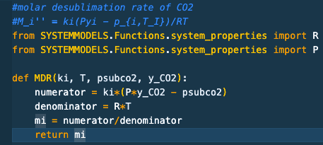

When you say finite difference equation for the gas-solid mass flux do you mean this:
$$\dot{M}_i^"=k_i\left(\frac{Py_i-p_i(T_I)}{RT_I}\right)$$
Is this considered a 'finite difference equation'? If this is the equation then I'll check for missing terms. I could well have missed something in the ##Sh_{loc,i}## equation or something

No, I don't think this is the equation I was concerned with. I was concerned more with $$\frac{dM_i}{dt}=\dot{M}_i^"A_s$$where $$A_s=\frac{6}{d_p}(1-\epsilon)A_c\Delta z$$But I think we already checked this out and agreed that it is correct. Anyway, please check again.

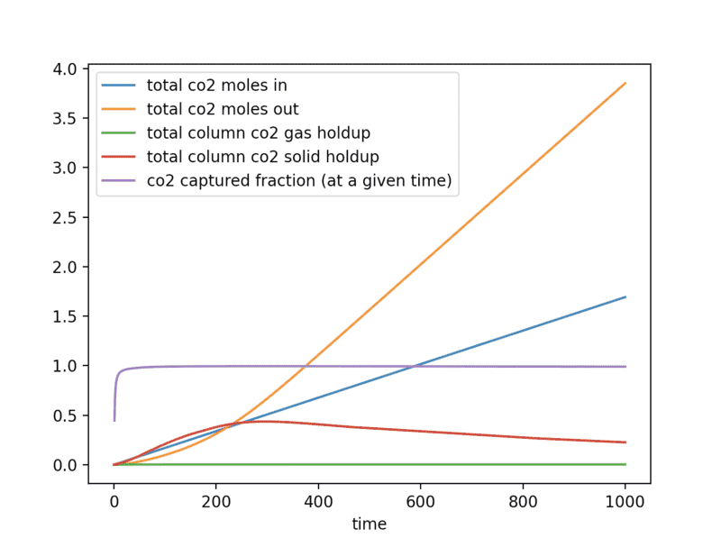

I think we should also check the overall mass balance on the CO2 at the selected times. Please calculate the total moles of CO2 that have flowed into the bed up to time t, the total number of moles of CO2 that has exited the bed up to time t, the total molar holdup of CO2 in the gas phase in the column at time t, and the total molar holdup of CO2 on the bed at time t. In addition to these giving us a check on the CO2 mass balance, they will also tell the fraction of the CO2 that is captured by the bed up to a given time.

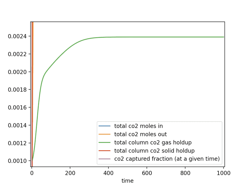

  • #313
$$M_{IN,TOTAL} = \dot{m} * t\tag{1}$$
Hmm. I think we could do that using the total molar holdup and the inlet flow, something like this:
$$M_{OUT,TOTAL} = \sum_{t=1}^{t}{\dot{m}_{IN} - m_{HOLDUP}}\tag{3}$$
Which I think is the sum of the outlet flows at all times in the bed
Hmm so we have to consider each tank individually here given the temperature profile.
The molar holdup of a single tank is ##(P/RT)(A_cdz\epsilon)##
So the total molar holdup would be:
$$M_{GAS} = \sum_{j=0}^{n}(P/RT_j)(A_cdz\epsilon)\tag{4}$$
I guess this is solid phase only, so:
$$M_{SOLID} = \sum_{j=0}^{n}(M_j)\tag{5}$$

Heres a plot of all the above variables versus time:
And zooming in on the total column CO2 gas holdup because its much smaller than the other values:

casualguitar said:
Change made
To implement the integration in code, can I do a cumulative sum here like this:
$$\int_0^t{\dot{m}_n(t')y_{CO2}(t')dt'} = \sum_{t=0}^t{\dot{m}_{out}y_{CO2,OUT}}$$
which is just calculating the outlet CO2 flow at all times and summing them together
Just use the trapezoidal rule, and don't forget to multiply by ##\Delta t##
casualguitar said:
Change made
In regards to defining the 'fraction of CO2 captured up to a given time'. So we agreed that 'captured' means 'in the solid phase', but what is this a fraction of?
I was thinking:
Fraction of CO_2 captured = ##\frac{M_{CO2,SOLID}}{M_{CO2,SOLID} + M_{CO2,GAS}}## at a given time, which is the moles of CO2 divided by the total mass of CO2 in the packed bed, at a given time
What this definition doesn't capture is the 'fraction of CO2 captured ##\textbf{up to a given time}##. The above definition can only calculate the fraction of CO2 captured ##\textbf{at to a given time}##, so I guess my definition above isn't correct, unless you meant at a given time rather than up to a given time?
I'll post those changed plots once the simulation finishes
The fraction of CO2 captured up to any time t would be the amount on the bed at time t divided by the amount entering up to time t.
  • #319
How can the CO2 moles out exceed the CO2 moles in? You need to multiply by ##\Delta t## in getting moles out.
At short times, how can CO2 holdup on the column exceed the CO2 that entered up to time t?
Yes ##\Delta t## is 1 second so I think the above applies
Got it, change made (wont post the plot yet because of that issue with the total solid deposited being greater than the total CO2 that entered the system)
Chestermiller said:
How can the CO2 moles out exceed the CO2 moles in? You need to multiply by Δt in getting moles out.
Well if the inlet flow is less dense than the density of the fluid in the tank then we would have a negative accumulation of CO2 i.e. moles out > moles in? ##\Delta t## is 1s here
Ah I see that. Hmm doesn't make sense. Checking my calculations. Actually if I increase the mole fraction of CO2 in the inlet flow then this issue goes away. Checking this now anyway
  • #321
No freakin' way. There is no CO2 in the column to begin with. So the cumulative amount coming out can never be greater than the cumulative amount you put in.

  • #326
casualguitar said:
Looks like an error in how I've set up the integrator to calculate the mass buildup
Just looking into this integrator integration a bit more - I'm printing out the value of both dMCO2/dt and MCO2 at each time, to check that ##M_{CO2,t} = M_{CO2,t-1} + dMCO2dt## when MCO2>0 and it doesn't seem to be:
There are two issues here. Firstly the rate of deposition is negative at the start, and secondly the above equation doesn't seem to apply anywhere.
Seeing that the sign is negative at the beginning, its possible that these are actually sublimation rates (which would be negative at the beginning), meaning that my logic to deal with MCO2<0 might be incorrect
  • #327
keep at it. you'll get there. This is why I suggested checking the overall balances.
