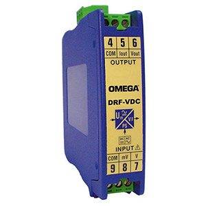

What you need is a signal conditioner to take a voltage input, say 0 to 1 volt, and outputs, 4-20mA. Conditioners like this
... are designed to accept a broad range of input signals, such as ac and dc voltage and current, frequency, temperature (thermocouple and RTD), and process transducers, and provide standard process outputs of either 4 to 20 mA, or 0 to 10 Vdc.
http://www.omega.com/pptst/DRF-VDC_VAC.html

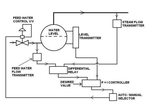

Start at the simplest mental model of the boiler.
Usually they're made from a huge round steel cylinder that may be vertical(as in PWR) or horizontal(as in fossil plant and some non-US nukes ).
So there is some relation between the amount of mass in the boiler and the level of the water.
If your boiler is vertical that's roughly linear, if horizontal it's not.
What you are controlling with flow is rate of water addition to the boiler.
So you'd want error to drive valve in the direction to correct that error - low level opens valve just as in a toilettank..
In a real plant it is typical to measure both the feedwater flow into and the steamflow out of your boiler. Next subtract them to make a "flow error" signal. This might get multiplied by some modest gain.
Flow error is then added to your level error signal and the result sent to the valve.
That's called "Three element" boiler level control.
It has the advantage that when steamflow changes, the valve immediately receives a signal to make feedwater flow match it , so you won't get much of a level perturbation.
Usually some integral is applied to the level error signal so that the system will eventually drive measured level to what is desired.
http://marineengineeringonline.com/marine-boiler-water-level-control/
