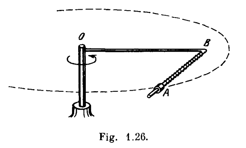

Let me assume that initially the spring is at its natural length.
The normal force acting in the vertical direction will manage the gravitational force.
And the normal force acting in the radially inward direction will provide the centripetal acceleration.
There is no force acting along the line AB. So, why will the sleeve move along AB at the first place?[/B]
You are right. If the initial condition is spring length = 0 and the length of the sleeve = 0, then it will stay that way.
If I was assigned this, I would also check to see if there was any other equilibrium states for any combinations of length OB, omega, x, and m.
There is also part 2 the question. How does the direction of rotation affect the reponse?

In the above post, what I meant is:
Let's say that the natural length of the spring is l0 >0. So, the sleeve is at a distance l0 from B, initially.
Now, using the argument given in the above post I claimed that the sleeve does not move along AB as there is no force acting along this direction.But,what I understand from your statements is that
there will be a force called centrifugal force acting on the sleeve along AB which will create its motion along AB.
The effect of this centrifugal force will tend to zero if we approximate l0 to 0 i.e.if the sleeve is at B and no spring force is acting on it.
Is my understanding correct so far?

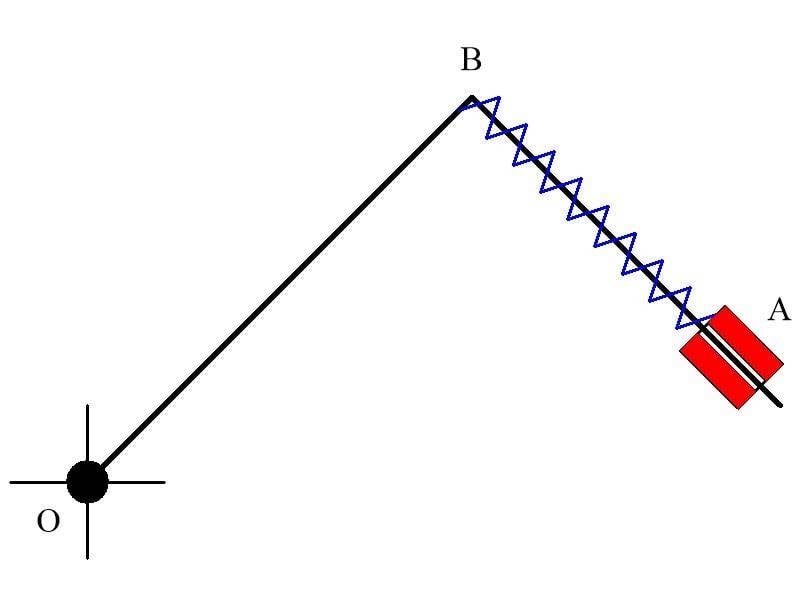

@Pushoam The sketch given in the problem statement is not very good and may be misleading you . This is the problem geometry shown as a true view looking vertically downwards :
Thanks a lot for this sketch.

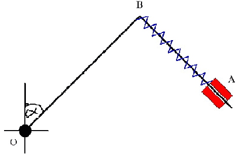

Let's denote the direction OB by ##\hat r ## and BA by ##\theta ##.
Wrt rod frame,
Let's say that at time t,
the sleeve is moving towards B from A and the spring is elongated with elongation ##l_e##.
l denotes the distance of the sleeve from B
the position of sleeve is given by R\hat R = ##r\hat r + l \theta## where r = OB
elongation## l_e = l- l_0 ## , where l0 is the natural length of the spring
the velocity of the sleeve ##\vec v = \frac {d \{R\hat R\}} {dt} = \dot l \theta = \dot l_e\hat \theta##
the acceleration of the sleeve ##\vec a = \ddot l_e \hat\theta ##
Now, eqn. of motion is given as
##\vec F_n = \vec F_p + \vec F_f##
where ##\vec F_n ## = net force acting on the sleeve wrt the rod frame
## \vec F_p ##= net physical force acting on the system =##- k l_e \hat \theta ## i.e.spring force + ⃗ ## \vec f## i.e. friction + ⃗## \vec N## i,e normal force + m ⃗##\vec g ## where k is the spring constant
⃗## \vec F_f ## = net fictitious force acting on the system =## m\omega^2 R~ \hat R - 2m\omega ~\hat z \times \dot l_e~\hat\theta ##
## m\ddot l_e \hat \theta =- k l_e \hat\theta - f \hat\theta +\vec N + m\vec g + m\omega^2R~ \hat R - 2m\omega ~\hat z \times \dot l_e~\hat \theta##
Taking ## \vec N + m\vec g =0##
##\ddot l_e \hat \theta = \{- kl_e - \frac f m \}\hat\theta+ \omega^2 R~ \hat R - 2\omega ~\hat z \times \dot l_e~\hat \theta##
Is this correct so far?
Pushoam said:
Taking ##\vec N + m\vec g =0##
No, the normal force also has a horizontal component normal to the rod.
For the rest of it, it looks ok, but I am never comfortable working with non-inertial frames.
Taking ## \vec N + m\vec g = N\hat r - mg \cos \alpha \hat r +mg\sin \alpha \hat \theta ##
## m\ddot l_e \hat \theta =- k l_e \hat\theta - f \hat\theta +\vec N + m\vec g + m\omega^2R~ \hat R - 2m\omega ~\hat z \times \dot l_e~\hat \theta ##
##m\ddot l_e \hat \theta =- k l_e \hat\theta - f \hat\theta +N\hat r - mg \cos \alpha \hat r +mg\sin \alpha \hat \theta + m\omega^2R~ \hat R - 2m\omega ~\hat z \times \dot l_e~\hat \theta
\\ \text { ignoring } m\omega^2R~ \hat R ~ and ~f \hat\theta~,
\\ \ddot l_e =\frac {k l_e} m + g\sin \alpha
\\ l_e = A\cos \sqrt {\frac k m } t + B \sin \sqrt {\frac k m } t + \frac{ m g \sin \alpha}{k}##
But this is not the required answer as the answer has to depend on ##\omega## and I ignored it. Am I on the right track?

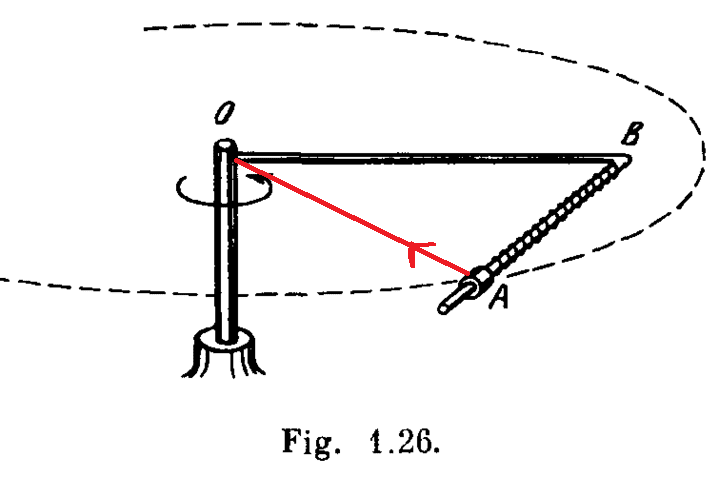

Try to formulate your solutions in terms of just one variable - this can be angle AOB or radius R or the stretched/compressed length AB of the spring .
I've shown the sleeve as a point mass in the lower diagram - what are the forces acting on it ?
(Two cases - one for each direction of rotation of the swing arm)
nb: Your angle alpha is not needed to solve this problem .
