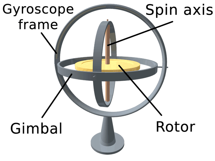

Sure. Gyroscopes do it all the time... :smile:
EDIT -- But see post #6 below for how to add the various rotations vectorially.
https://upload.wikimedia.org/wikipedia/commons/e/e2/3D_Gyroscope.png
Theorem. Suppose that a rigid body has a fixed point and moves with nonzero angular velocity: ##\boldsymbol \omega\ne 0##. Then at each moment of time there exists a unique line belonging to the rigid body such that the velocity of any point of this line is equal zero.
This line is referred to as axis of rotation

So then would the two axis of any object have to be perpendicular to each other? And is there a limit to the number of axis an object can have at the same time?
You can decompose the total angular velocity vector into arbitrary many vectors.
