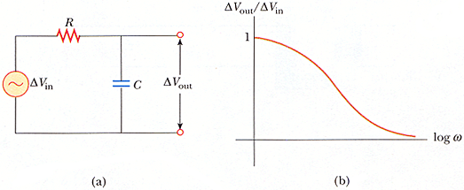

6. The RC low-pass filter shown in Figure 33.26 has a resistance R = 90.0 and a capacitance C = 8.00 nF. Calculate the ratio (Vout/Vin) for the following input frequencies.
Figure 33.26 http://www.webassign.net/pse/33-23.gif

7.An 80.0 resistor, a 170 mH inductor, and a 0.130 µF capacitor are connected in parallel across a 120 V (rms) source operating at 374 rad/s.
