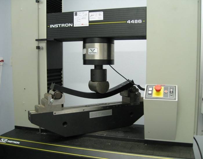

Are you trying to create a 3-point flexural bending test?
Please describe the nature of the failure.
