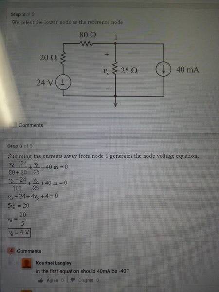

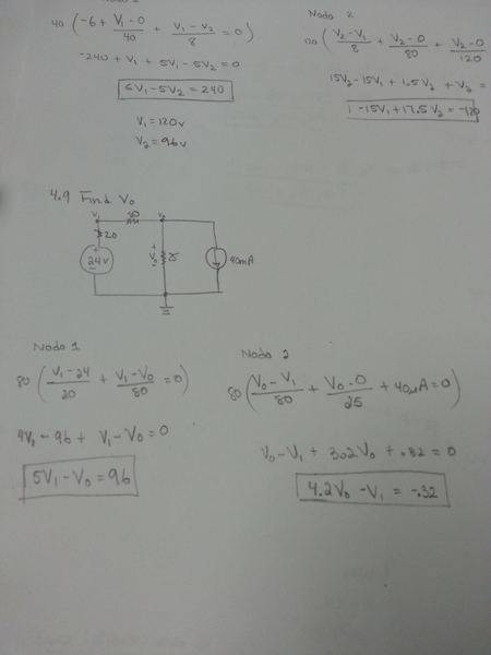

My question about this exercise is the 80+20 part in the denominator. Why and when do I do that? I tried doing it but got the wrong answer

There is a single series-connected path from node 1 through the two resistors and the voltage source to the reference node. So the total resistance along that path is the sum of the two resistances. That makes the current through that branch (V1 - 24V)/(80Ω + 20Ω).
There's no need to introduce extra nodes along a series branch; just add up the voltage sources and resistance values.

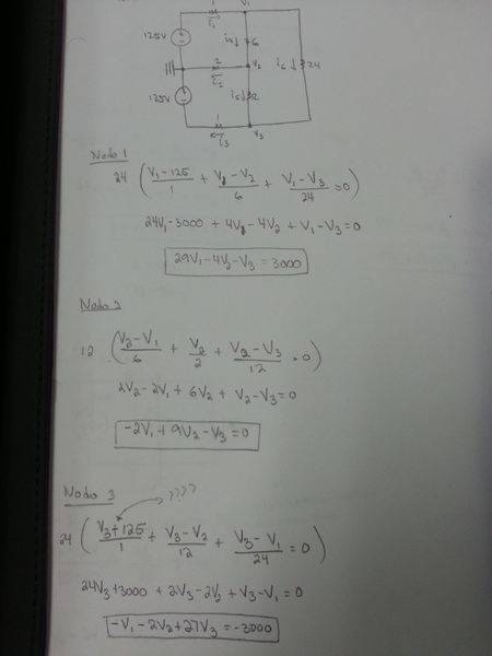

How about that +125 in node 3. I had it as V3-125. Why is it positive

It's positive because of the polarity of the 125V source along the path from node 3 to the reference node. The potential at its "-" terminal is effectively 125V below the reference potential. Since the potential of node 3 is measured with respect to the reference node, this makes the total potential across the resistor V3 + 125V.
When in doubt, do a "KVL walk" along the path and add up the various potential changes. Starting at the reference node:
-125V + i3*R = v3
So the current is (v3 + 125V)/R
