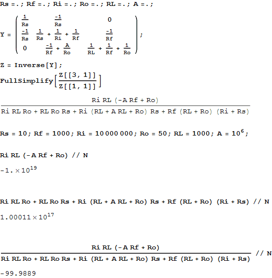

Problem statement is in the attachment HW 5, it is problem #1.
I am just stuck with a whole bunch of variables and this just looks like a complete mess
The best and the easiest way to solve this circuit is to use a matrix. And then use the math software and allow the computer to solve the matrix for us.

Your equations look right.
I have 2 suggestions:
1. Instead of R, use G=1/R for all resistances. Makes the math look cleaner by eliminating fractions in your two basic equations.
2. Put your basic equations into math software. Don't try to solve them yourself; you are liable to make a mistake.

You must have made an error in your arithmetic. I get -99.9889 for the gain.
I do it over and over and get the same result, are you getting -9.99999E+24 on the top of the fraction, and 1.000E+17 on the bottom?
Here's the result I get:

Because I made a stupid mistake not in the matrix but in input 5. The gain is A times larger than is should. To correct this simply remove the first A in numerator
correct numerator = Ri RL (-A Rf+Ro) = Ri RL (Ro - Rf A)
Sorry for confusion.
