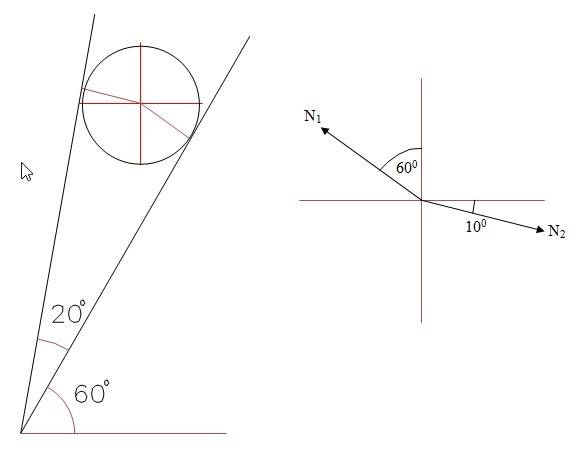

The walls are smooth, calculate the reactions. the cylinder weighs 100[N].
Now the 600 wall is rough with a friction coefficient 0.4. what are the reactions
Friction: F=μN
I made the first step and it was good: N1=287.9, N2=253.2
But with friction there is another force, tangential, but the results in the book are the same.
  • Free-body diagram of a cylinder resting between two inclined walls at 60 and 20 degrees from the horizontal, with normal reactions N1 and N2 shown at 60 and 10 degrees from the axes.
You got the first one correct? Because I'm getting different answers.
As for the second part, what I think, is that the cylinder is stationary, in equilibrium. There is no resultant force on it. So which direction will you consider the friction to act in?

I agree with Karol's answers.
If the cylinder is in equilibrium when there is no friction, and then the only change that is made is that a coefficient of friction is added, then why would a force of friction act?

Karol said:
Friction: F=μN
For the case of static friction, that is only the maximum, not the applied force.
I may agree if μ is added later. but the forces can arrange themselves differently (only magnitudes) to accommodate the changes.
Maybe because there is no relative movement without the friction force anyway it isn't created.
More accurately, it would be because there is no tendency to move.
However, the question is not really correct. While there need not be a frictional force, there could be one. You could find a solution to the equations in which the walls exert a greater normal force and, to balance that, a small frictional force. In the real world, this corresponds to the cylinder being jammed in.
