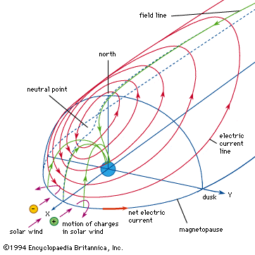

Let's suppose a solar electron moving directly towards Earth's equator at a high speed. This electron meets Earth's magnetic field, which points to the north, at a distance ten times the Earth's radius, where magnetic field is almost uniform. Which will be the direction this electron describes?
Attempt to solution:
At the first moment, magnetic field yields the electron to the West. This is the result of the cross-product between two vectors: velocity and magnetic field. Eversince, where does it go?; why?

I'm asking what the electron does once it's been deflected. The text-book I am reading continues saying, in a brief text, that some of the electrons will be engaged to the magnetic field and sent to the poles. West at the first time, North and South at the end. The question is: what happens to the electron once deflected. Does it turn North, trapped in the magnetic field?; does it sorround west hemisphere before joining the magnetic field?; how can it end at the south, despite the magnetic field, that leads to the North?. The problem is that I've been given very few information. I know the first step, which consist in the cross-product and its inmediate consequence: a force with direction West: does it mean electron first goes West?; what must I understand by West?.

Watching the picture I can see the electrons and the protons are deflected, away from the Earth, by the magnetic field.
At the very first moment, the electron to the west of the magnetic field; and then (this is what I ignored until I've seen the picture) it describes a circle, to end up turning round and away from Earth.
Some of these particles get trapped in the magnetic field, and travel to the poles. The auroras seen near the Artic and Antartic latitudes.

Then forget about it again, because it's confusing. Just use the right-hand rule all the time. If using it to deal with magnetic Lorentz forces, ##\vec{F}=q \vec{v} \times \vec{B}##, remember that for the electron ##q=-e<0##!
