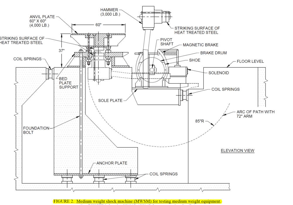

Can you show us a better diagram of your actual unit. If your hammer is hitting a striker plate then that might be a route to a calculation of its impact force based upon the hammer and striker plate materials.
Let me find one in the spec.
Here you go.
Edited for clarity:
OK, now basically we have a 3000 lb hammer with a given amount of energy and vertical velocity striking a hanging 4000 lb anvil plate with little motion resistance other than its weight and inertia. So what is the velocity of the anvil plate after impact and how much force is required to accelerate the anvil plate to its velocity (if that is the right question)?
With a bit of scaling on the picture and basic calculations I have estimated the the Hammer KE = 172,500 in-lb and v = 10.72 in/sec at impact.
(See above post for the figure of actual machine)
At this point I need some mentor and member inputs regarding the above problem description.

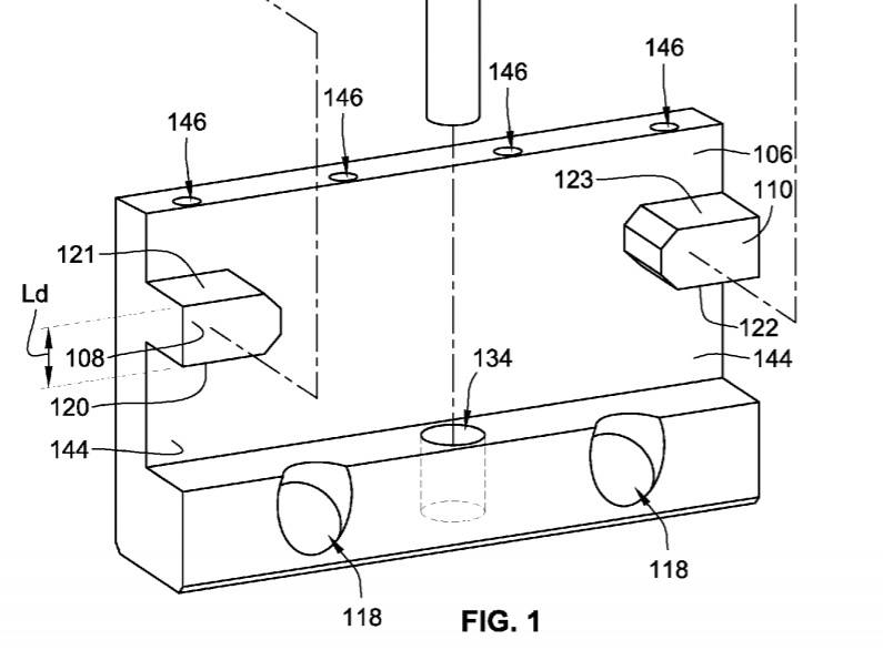

I used a similar method to find out why lugs 108 and 110 in the figure below broke when the calculated strength was about 100 lbs, and the force was from a spring similar to the spring in a ball point pen. The figure is from US Patent Application 13/350544 with publication number 20130184139.

Let us simplify things. The change in potential energy of the hammer is known, so the velocity of the hammer at impact is known from the kinetic energy. A short time after contact, the hammer will separate from the anvil. The anvil will have quickly gained a vertical velocity. I believe that anvil velocity change is being assumed to be an instant step function. I do not believe the exact acceleration of the anvil is important in the test.
The equipment resting on the anvil will be lifted with the anvil. The time it takes the item to accelerate to anvil speed, will depend on the elastic isolation mountings employed in the equipment being tested.
The testing machine appears to be used to simulate the effect of an underwater mine or torpedo explosion on a ship. It is used to verify that equipment will survive a specified impact.

All I can say is that the machine provides a standard reproducible, virtually-irresistible, vertical-velocity step-function.
