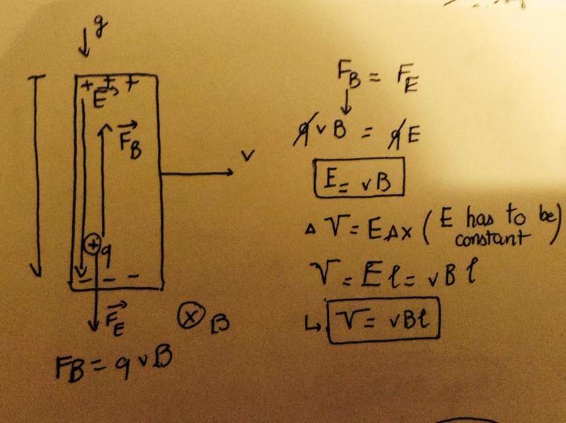

Hi guys,
In the photo is the problem. We set Fb =Fe to show for E then out E into the Voltage equation to get V=vlB. However, if we won;t ignore the gravity force, what is the percent correction? (Note: q =Electron)
Welcome to PF;
What is the definition of "percent correction" - that will tell you how to work it out.
In the presence of gravity - draw a free-body diagram for the electron.

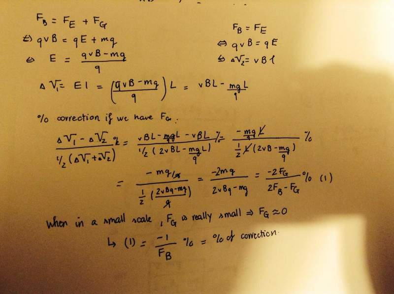

i did a little work, but idk if it is right?
You missed out defining what "percentage correction" means.
What are you correcting and why?
The fbd and calculation seems OK.
qvlB = qV + mgl
So V= vlB-gl(m/q) with gravity
Without gravity: V0=vlB
If you used B=V0/vl with V0=V then you have introduced a systematic error into your equation for determining B.
