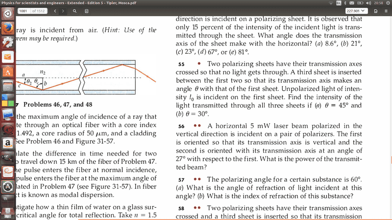

Hi guys I am having a problem with this question
Q55 a) and b)
My problem is that for part a) I used the following logic. That if two sheet won't let light through at ##90^\circ## so if a 3rd sheet is inserted between the two the angle between each is ##45^\circ##, But for part a) ans b)seem to be getting something wrong. I assume the the light I will show my working below.
##I=I_0cos^2\theta##
[/B]
a) light from sheet 1 to sheet 2 is:
##I_{1,2}=I_0(cos45)^2=\frac{I_0}{2}##
light from sheet 2 to sheet 3 is:
##I_{2,3}=\frac{I_0}{2}(cos45)^2=\frac{I_0}{4}##
but the ans is \frac{I_0}{8}
which is where I am confused is the first sheet be put at and angle of 45 degrees when light enters beacuse I was under the assumption the the first sheet is perpendicular to the last sheet at it is the sheet in the middle that is only 45 degrees.
I am having the same issue with b) thus why I have no workings
The ##I_o## in the law of Malus is usually taken to be the light intensity after the first polarizer. You need to first find out how that ##I_o## relates to the initial incident unpolarized light intensity :wink:
Ah yes I see now, that on average the electric field is 45 degree w/r to the trasmission axis. So the through the firs filter it would be ##I=I_0\frac{1}{2}##
thank you very much for your help
