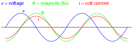

That is when you first establish magnetization in the core.Here's steady state operation, from a decent article at
http://www.allaboutcircuits.com/textbook/alternating-current/chpt-9/practical-considerations-transformers/
observe that at zero volts flux is always at a peak, as is magnetizing current.
So - if you de-energize it, voltage current and flux all three fall to zero.

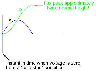

If you re-energize it, you need to do it at a voltage peak so that flux starts from the correct value. Otherwise there'll be some sort of transient as flux and voltage re-establish their steady state relationship, 90° and centered on zero.
Worst case is to re-energize on the zero crossing.
That's because so long as voltage is positive , flux is increasing
... and if flux started from zero instead of its negative peak it has to go twice as high as normal.
Most transformers don't have enough iron to carry that much flux,
so they saturate, and the current goes sky high trying to push enough magnetizing current to produce that much flux in iron that's saturated.

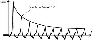

Inrush current looks like this as the voltage-flux relationship restores itself to normal.

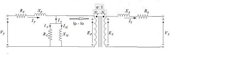

Here's your circuit model of a transformer ,from Wikipedia i think
It has at its heart the ideal transformer in middle which can neither saturate nor overload and needs no magnetizing current .
Magnetizing current flows down into Xm . If we want our model to approximate a real transformer, Xm must have a B-H saturation curve like a real transformer.
Load current flows through the ideal transformer not Xm. Inrush to a load affects Xm only by causing voltage drop across Rp and Xp.

Ah, yes... I should have differentiated between Load inrush and Transformer inrush. Any transient or fault type current flow "outside" the transformer will simply propagate through the machine since, as the OP has pointed out, the transformer is a "stupid" machine.
To further illuminate the OP's question, using the secondary winding as the "high side" to step-up the voltage would yield the same inrush as if you'd connected it as intended. This is due to the consideration given to the number of turns. If you use the side with fewer turns but higher voltage, it would, ideally, produce the same inrush as if you'd used the side with more turns, but smaller voltage. Now this ideal relationship is not too useful, but, unless you're considering an overloaded transformer, it's useful for this case.
Be sure if you use the transformer model to swap the values of the Rp and Xp with Rs and Xs and use 1/a rather than a.
