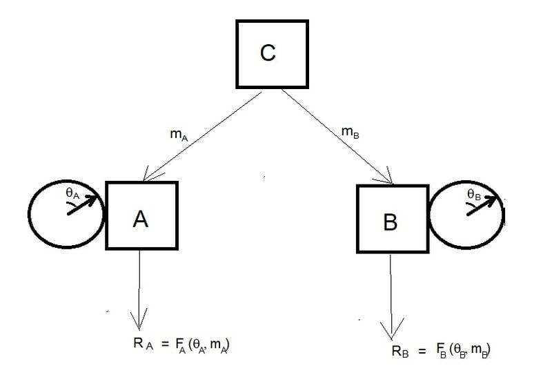

The issue for local realism would be to have three computers connected in a network. Call them A, B, C. Computer C can send messages to A or B, but receives messages from neither. Computers A and B send no messages, but receive messages from C. The programs running on A and B have settings, where a setting amounts to a specification of a direction in space (we can specify this by a pair of real numbers \theta, \phi, with 0 \leq \theta \leq \pi and 0 \leq \phi \lt 2\pi).
We have a number of rounds, where each round consists of the following steps:
  1. C generates a pair of messages, m_a and m_b, using whatever means (random or not). (These represent the states of the electron and positron, respectively)
  2. C sends m_a to computer A, and sends m_b to computer B.
  3. After the message m_a is sent, but before it is processed by A, a user chooses a setting for that computer: \theta_a, \phi_a. (These represent the Stern-Gerlach spin measurement orientation)
  4. Then, computer A runs an algorithm F_A(m_a, \theta_a, \phi_a) to determine a result, R_a, either +1 or -1. (This represents the process whereby the particle interacts with the Stern-Gerlach device to produce an outcome of spin-up or spin-down)
  5. Similarly, a setting is chosen for computer B, and it computes a result F_B(m_b, \theta_b, \phi_b) (The result, R_b is again, either +1 or -1)
This simulation would count as a local realistic simulation of EPR if, regardless of how the settings are chosen at step 3 (except that there would need to be enough variety to get good sampling), for any fixed \theta_a, \theta_b, \phi_a, \phi_b, we would have:
\langle R_a R_b \rangle = -cos(\psi)
where \psi is the angle between the direction specified for computers A and B and where \langle \rangle is the average value, over many runs.
Bell's theorem implies that no matter what algorithms are being used by computers A, B or C, you can't reproduce the predictions of QM. There are various loopholes or ways to cheat, though, including:
  1. If A and B are allowed to communicate.
  2. If the settings are chosen predictably (and the pattern is used in the design of the program running on C)
  3. If the settings are chosen before C sends its messages, and C is told the choices.

But there are three different "actors" involved in EPR: the two detectors and the source of correlated twin pairs. If you simulate all three on the same computer, then of course, you can reproduce the predictions of QM. But if the detectors and the source are simulated on different computers, then you can't. Not without either communication among the computers or "superdeterminism" (the settings of the detectors is fixed ahead of time and known to the source).
Demystifier said:
Of course it's possible. The catch is that spacelike separated (i.e. ##(\Delta x)^2-c^2(\Delta t)^2>0)## events in the real world are represented by computer memory states which may not be spacelike separated in the computer. But if you want computer to simulate QM in real time and space, then it's impossible.
Well, the timing is not really the issue. The issue is communication. You have three actors--a source of twin-pairs, and two detectors. If the only communication allowed is one-way from the source to the detectors then there is no way to reproduce the predictions of QM. Well, there is actually the "superdeterminism" loophole--if the settings of the detectors are predictable ahead of time, you can violate Bell's inequality.

I was using the spin-1/2 case, but we can use the photon case if you like. So you have Bob in one room with his computer, Alice in another room with her computer, and Charlie in a third room with his computer. Charlie sends two messages, one to Alice and one to Bob, representing a twin pair of entangled photons leaving from some common source. Alice and Bob each independently choose a filter orientation. Alice's algorithm takes the message from Charlie and Alice's orientation choice and returns a number +1 or -1 (to represent passing the filter or being blocked by the filter). Bob's algorithm takes the message from Charlie and Bob's orientation choice and returns a number +1 or -1.
So what do you mean by "use the probabilities given by QT"? QT predicts joint probabilities:
P(A = B|o_A, o_B) = cos^2(\psi) (where \psi is the angle between Alice's and Bob's orientations)
where A is Alice's result, o_A is Alice's orientation choice, B is Bob's result, o_B is Bob's orientation choice.
But Alice's computer doesn't have access to Bob's orientation, and Bob's computer doesn't have access to Alice's orientation. So how can you implement that joint probability?

In the setup I described, the source machine, C, creates pairs of messages (representing photons). They aren't independent, they're as correlated as the machine wants to make them. But the detection processes, at machines A and B, are independent.
