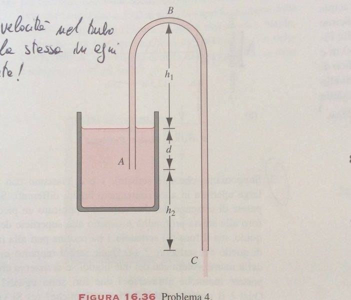

What is the pressure at point B in a moving liquid with density ρ?

Considering the figure. The liquid has a density $$\rho$$. What is the pressure at B?

In a solution that I have found on internet, it is said that the pressure in B is $$p_0 - \rho g (h_1 + d+h_2 )$$. How is it possible? I thought that the pressure at B was $$p_0 + \rho g (-h_1)$$
I post the photo
That would be true in a static arrangement, but the fluid is moving. Try Bernoulli's equation.
