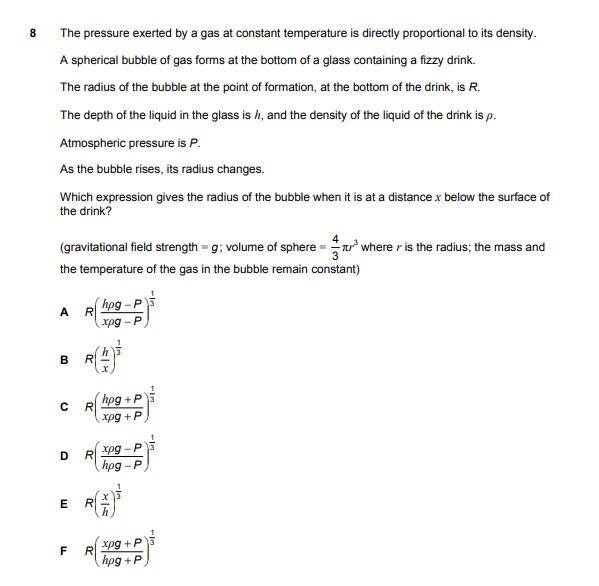

The correct answer is 'C'.
I'm having trouble understanding the solution shown on this link (http://www.engineeringadmissionsassessment.com/2019-solutions.html) - scroll down to Section 2, Question 8.

So, as the bubble rises from the base to the given height, the bubble changes volume, in order for the pressure outside = pressure inside?
Yes.
If pressure inside had remained the same while pressure outside declined, the fluid at the boundary would be under an unbalanced net force. The bubble would expand, forcing that fluid outward.
Which is exactly what happens. The fluid is forced outward, the bubble expands, its volume increases and its pressure declines so that a new equilibrium is attained.
