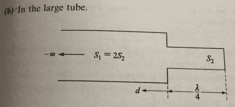

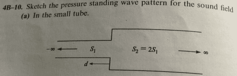

See pictures. There are 2 parts to the problem but I can probably figure out the second part once I get the first part. [/B]
Antinodes (minimum pressure) at
Nodes (maximum pressure) at
[/B]
Equation for a standing wave:
Other than what I've written above, and that it's sinusoidal, not sure what the problem is looking for here. Any hints would be highly appreciated. Thanks for looking.
I think they are asking you to show where nodes and antinodes form. For example you normally get an antinode at the open end of a tube. However I'm not sure what you get at the transition between the two tubes. I never studied that.
Hi thanks for responding. Here are the formulas for the reflection and transmission coefficients:
where S1, S2 are cross sectional areas.
R=1 if S2<<S1, a sudden strong area contraction almost acts as a rigid wall.
R=-1 if S2>>S1, in this case the junction acts almost as a pressure-release surface.
