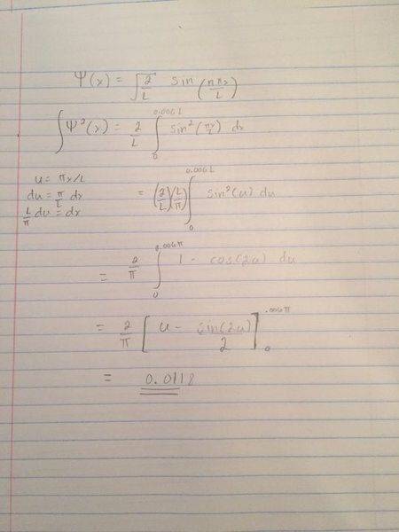

The problem states that because Δx is very small I don't need to do any integration. I've been integrating anyway because it's fun in this particular case- but my problem is what to do with x = 3L/4. I've integrated up to x= 0.006L in ψ2(x) and I'm getting the correct answer for if the particle was at x=L/2. What do I do here?
You show your work and then we can comment :smile:. 'up to x = 0.006 L' makes me feel uneasy: up to x = 0.006 L from where ?
So here is the integration from 0 to 0.006L. I tried the integration from 0.006L to 3L/4 also and I am getting a number greater than 1...

Disaster ! But the original exercise asks about probability to find the bugger in an interval of width 0.006 L at 3/L/4 , so I would be reassured if you integrated from 0.75 L to 0.7506 : or so. Since the sine varies only little in uch a small interval, you can just take the value. But, if I may ask: what do you integrate (what's the integrand) ? (edit: never mind, iI can see you do it right from the grey-on grey picture). Now about the value.
I figured that since at L/2 there would be the highest probability at that point. At 3L/4 you're a little bit further right in the well and since the probability of finding a particle represents a sine wave then it would have to be a number smaller than what I got integrating from 0 to 0.006L (which was twice 0.006L) but how are you to know that it's at exactly 0.006L?
Doesn't sound good to me, but I can be wrong...
[edit] no, sounds good to me. Why ?
The integrand is √(2/L) sin2 (nπx/L)
You missed a factor 1/2: ##\quad{\bf 2} \sin^2x = 1-\cos 2x##
[edit] and the numerics look mistaken too: for small x , ##\ x-1/2 \sin2x ## should be closer to 0.
so at 3L/4 that sine squared is 1/2, and ## {2\over L } {1\over 2 } 0.006 L = 0.006 ##
Simple exercise, lots to learn !. (not only you, me 2)
