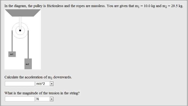

In the diagram, the pulley is frictionless and the ropes are massless. You are given that m1 = 10.0 kg and m2 = 29.5 kg.
Calculate the acceleration of m2 downwards.
What is the magnitude of the tension in the string?
sum of F= M*A
I tried doing a free body diagram and solving for A but I still can't find the tension...

OK, you have written Newton's Law. Draw a free body diagram of each weight calling the tension in the rope T. You should have two equations. Let's see them.
m2:
force of tension going up
force of gravity going down
t1-w=ma
m1: same thing ...
t1-w=ma
Let's use some subscripts because the masses/weights are different:
T - w1 = m1 * a
T - w2 = m2 * a
Looking at what you've written, you'll need to define what w1 and w2 are. Also, you have a single variable for acceleration. But the accelerations are in opposite directions so what must be done?
So I have w1 and w2 and I have m1 and m2. Whats missing is T and A. Can I just solve for A or T ?

Yes you can but if you do you'll get an incorrect result. You have an error in one of your equations. Acceleration, like 'g', has a direction associated with it.
