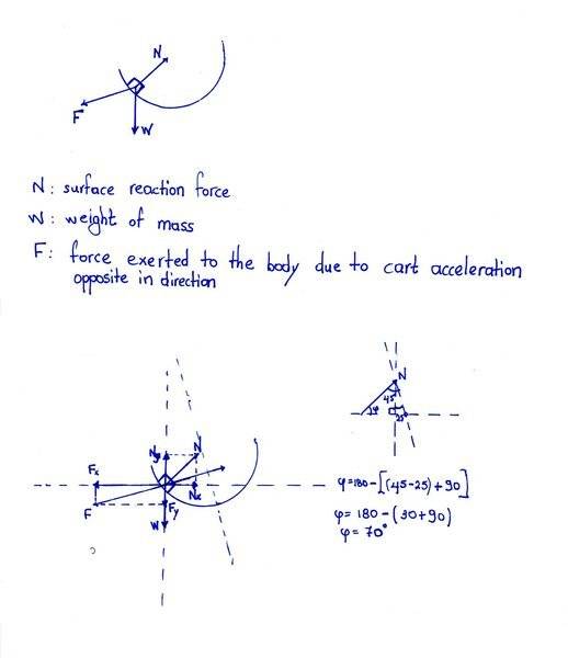

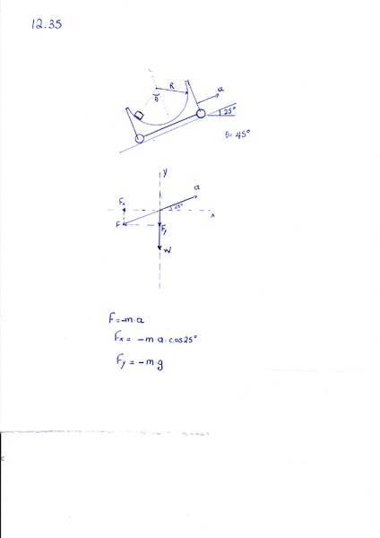

The cart carrying the small 9-N package A is moving up the incline with constant acceleration α. If the package stays at rest relative to the cart in the position θ=45deg, determine the value of α. Neglect friction.
[/B]
Are my equations correct?
Also how do I continue finding α? Does the ##θ=\frac {s} {r}## comes into play?
Hard to tell if you do not define your variables.
What forces act on the mass? (I assume you are to ignore friction.) What are the magnitudes and directions of those forces? What is the magnitude and direction of the resultant force?
Here is a body diagram.

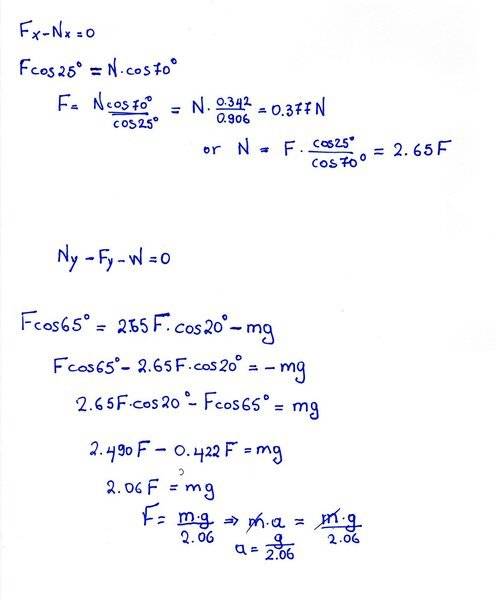

and here is my solution:
Can you check this and tell me if it is correct
