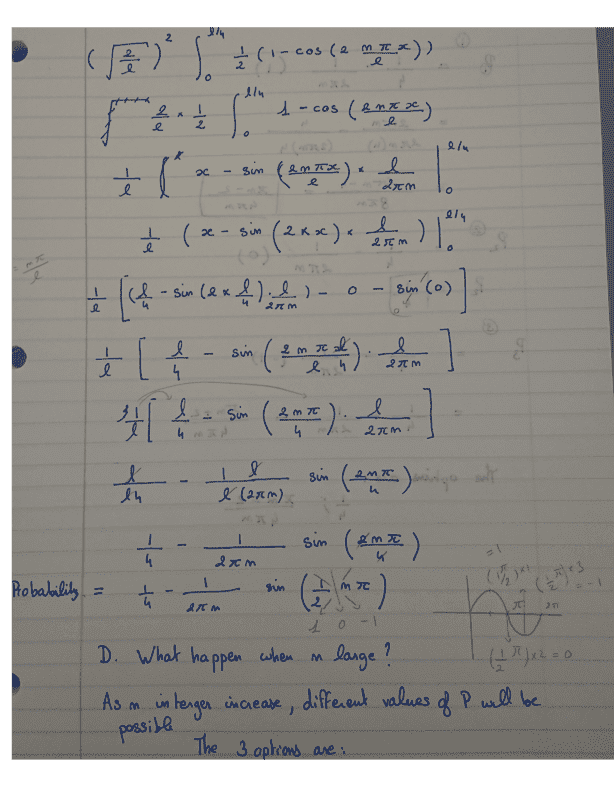

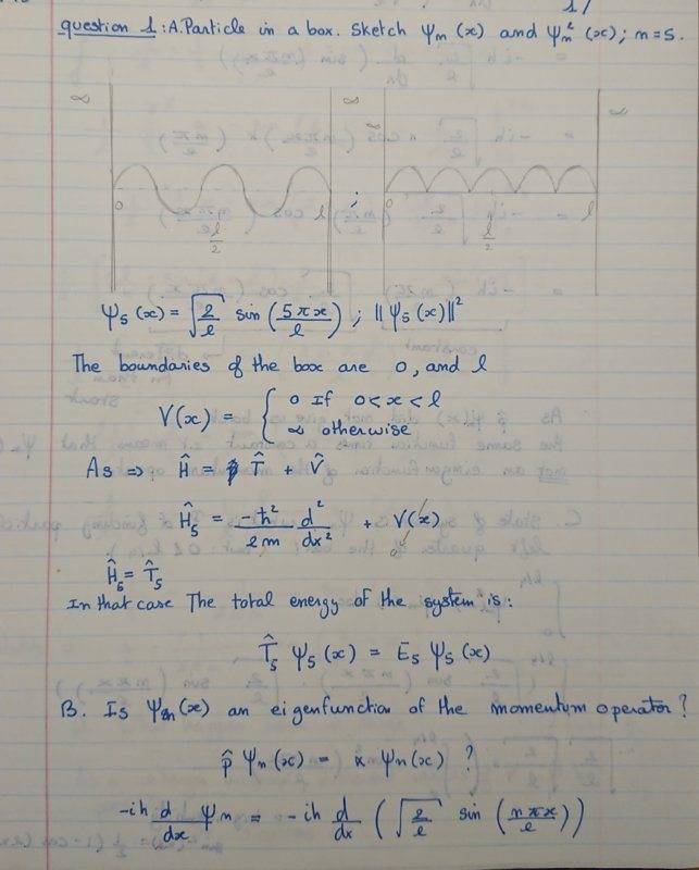

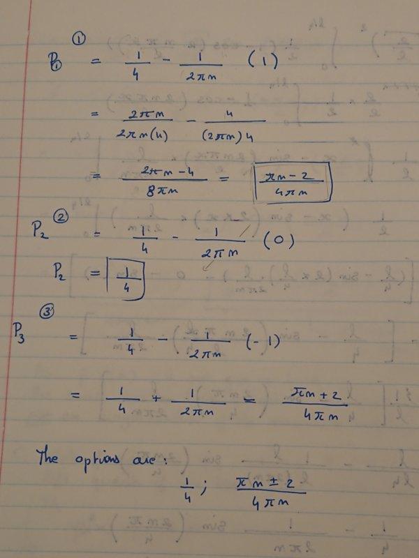

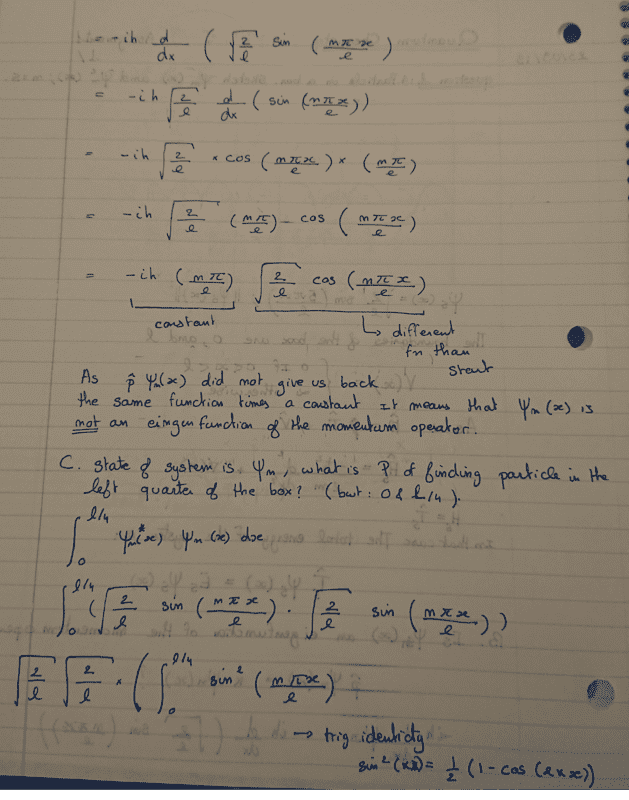

For the particle in a box, sketch ψn(x) and ψn2(x) for n = 5. Is ψn(x) an eigenfunction of the momentum operator?
If the state of the system is ψn, what is the probability of finding the particle in the
left quarter of the box between 0 and L/4? What happens when n is large?
ψn = sqrt(2/l) sin (npix/l)
Here is my attempt at a solution. The thing I am not sure about is the final result of the Shrodinger equation and the n-values that are offered?
Did I make a math mistake?
Thank you so much for reading through this!
Apply l'Hospital's rule to deduce that
\begin{align*}
\lim_{m\rightarrow\infty}\frac{m\pi \pm 2}{4m\pi} &= \frac{1}{4}
\end{align*}
and conclude that the probability for finding the particle in the leftmost quarter of the box is ##1/4## at high energies (i.e. large ##m##).
