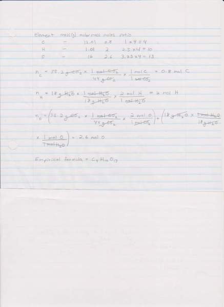

ok I understand why now, because dry oxygen gas was used to burn the unknown sample in the analyzer
on Phys.org
  • #32
Not so obvious. I agree the C/H proportions give you C8H20 which also fits the molar mass nicely. But as the OP said there are no C8 compounds that can fit that ratio. There is too much H.
But even if you have oxygen in the compound, it doesn't help as far as I can see. If you replace any C-H with C-O-H you don't increase the H/C ratio. So i see just two ways to increase the H/C. One is by water of crystallisation. But then to be plausible you have to incorporate O into the molecule as well. Considering the molar mass I think this needs to be a C4 molecule in which case you could fit the C/H ratio even without the water of crystallisation. There is an outside possibility with a C6 molecule and water, but I can't see anything that adds up in either case.
I am taking it that any molar mass measurement that works at all will give you the MMass of compound without the water, and that we can take the accuracy of the measurements given as good.

Maybe I've got it! Maybe we were meant to bring in something that was mentioned and then forgotten - nitrogen. When I include the possibility of N and use the well-known approximate whole number atomic masses there is a solution that I think is unique.
The only trouble is when I calculate it using accurate atomic masses I have disagreement with the given 116.26 by about 0.1 - a whole 1 in 1,000 discrepancy!:blushing: Perhaps the OP could try the calculation with this idea, or someone else check the figures, or maybe I've overlooked some other solution?
That incredibly accurate molar mass figure given makes the problem look to me a contrived one. Surely a figure that accurate could not be result of experimental measurement; one would only calculate that figure once one knew the answer?

I have read that webpage that you posted. How would I determine the mass of the unknown element in the unknown compound ? Do I assume 100 g ? so then I can subtract the mass of carbon & hydrogen from 100 g to get the mass of the unknown element. But I don't know the molar mass of the compound :( this sucks...
  • #39
ghostanime2001 said:
to be very honest, I am stumped on this one, from head to toe.
Most of the progress so far you made yourself so don't give up. Stumped by negative results is different from stumped by not trying. You got C8H20. But you realized that's is chemically impossible by itself. You cannot get that proportion of H to C with C and H alone. Not with C20. But you can with a smaller molecule. Not just anything smaller, the ratios limit you to few possibilities. List them. But then a smaller molecule doesn't have mole mass around 116. But we are free to, and we have to, make up that mass with O and/or N atoms.
(I could also have got to the same conclusion saying adding O to my C20 doesn't increase the possible H/C as explained previously. I can increase the ratio if I have N in the molecule. But that will make the MM greater than 116 too, unless the number of C is less.)
So try some possibilities and report even results that seem negative or we can't help you.

@epenguin: While I can find a C,H,N,O combination with the approximate molar mass, how would that look like as a molecule? I think you get 1/2 of a bond somewhere, or a missing/additional hydrogen.

The OP seems to have abandoned, though the next step is very easy - we have established that there are less than 8 carbon atoms and I think most people know all the numbers that are less than 8.
That seems to me to swiftly lead to a unique answer that is anywhere near; it is as I said very near but not quite. Assuming this is the molecular formula I do after all find it difficult to think of a molecular one. Well I did find one that is notoriously semi-stable. :wink: I say one, but you are always going to get several for the price of one as you can move groups about. These searches could be a bit formalised, I am halfway doing that. Keep getting near, but there is a conspiracy giving me one H to many or too few - when you change anything you usually gain or lose two H, but I have not concluded.
That is not just bad luck, it is a fundamental problem and the basis of my post #42.
You can calculate the number of hydrogen atoms needed if there are no rings and no double bindings - for the number of C, N O you assumed, this is an odd number. Every ring and every double binding reduces this number by 2 - you always keep an odd number, this does not fit to the even number you need to satisfy the C/H ratio together with the molecular mass.
That's why I asked if you can imagine a molecule with that. Otherwise, this direction leads nowhere.
