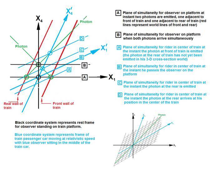

goodabouthood
127
Can you give me some "real life" examples of simultaneity?
For instance I know the one about the train and the lighting strikes but I was under the impression that this only holds up if the train is moving close to the speed of light.
Thanks.

Thats not an example of the principle of relativity of simultaneity or what ever it`s called.
Time dilation / length contraction cause issues with what observers agree happened simultaneously.
The relative speeds / gravitational potential don`t have to be significant fractions of c to become apparent, your measurements have to be more accurate.
However I do think it is kinda related to distance, because c is invariant.
The example is not correct. According to both person A and person B, the light is switched on at the same time, since the people have no relative motion.
You only need to worry about the relativity of simultaneity when objects are moving at a significant fraction of the speed of light. Two good examples are particles and satellites.
So you are right in thinking relativity of simultaneity doesn't matter in 'every day life'. If we consider only the reference frames of people, then simultaneity is approximately absolute, because all people have very small relative speeds (as a fraction of c). So if two events on Earth are simultaneous according to me, then they are approximately simultaneous according to everyone else on earth.
Nitsuj is right that simultaneity is always relative, its just that we don't notice it in every day life because the effects are tiny compared to the precision our measuring equipment.

It looks like you're trying to make sense of 'relativity of simultaneity' by making a line of reasoning using the fact that light propagates at c according to all observers.
It is possible to make a line of reasoning this way. One way to do it is by the mind-experiment of the train and the lightning strikes (as you already mentioned).
But the example you're developing doesn't make a similar line of reasoning. In your example, the reason the people experience the flashes of light at different times is simply because they are in different places.

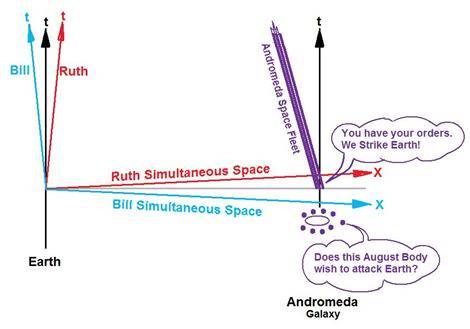

Here's a real life example: Bill and Ruth walk past each other on the street. Since they are in motion relative to each other, they are each living in a different instantaneous 3-dimensional world, each one being a different cross-section of the 4-dimensional universe. Thus, in Bill's world a meeting is taking place in the Andromeda Galaxy in which it is being decided whether or not to attack earth. However, at the instant Bill and Run are passing each other, Ruth is living in a different 3-dimensional world from Bill (an instantaneous cross-section of the same 4-dimensional universe) in which the Andromeda leaders have already made their decision and the Andromeda Space Fleet has already been launched and is heading toward earth.
This is of course the example posed by the renowned physicist, Roger Penrose ("The Emperor's New Mind"), known as the Andromeda Paradox.
Disclaimer: Bill and Ruth passing each other, living in two different 3-D cross-sections of the universe is a real everyday happening. But, the attack of the Andromeda fleet is made up (I hope).
