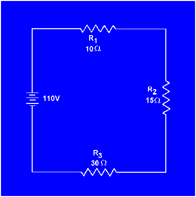

The current isn't decreased ( that's an incorrect assumption) its just limited by the resistance of the circuit.
In this 3 resistor circuit below, the current flowing at any point in the circuit is the same. it DOESNT change. The current flowing in the circuit is determined
by the total resistance of the circuit I = V / R.
It doesn't matter where you measure the current you will get the same result. between the battery and R1, between R1 and R2, between R2 and R3, or
finally between R3 and the battery
Series circuit diagram with a 110V battery and three resistors in a single loop: R1 = 10 Ω, R2 = 15 Ω, R3 = 30 Ω, drawn on a blue background.
cheers
Dave

Further to the previous post...
What is decreasing as you go around the circuit is the voltage.
There is a voltage drop across each resistance.
firstly work out the current flowing in that circuit I = V/R. Once you have that current
then you can work out the voltage drop across each resistor V(R1) = I x R1, V(R2) = I x R2, V(R3) = I x R3.
those 3 voltage drops will add up to the total voltage supplied by the battery (or other voltage source)
Dave
EDIT...
think of this real world situation ... I have a 12V, 5 amp plugpack, my MP3 player needs/uses 12V and 750mA (milliAmp). so what happened to the 4.25A ?
is it decreased ? NO, just because the plugpack can supply a maximum of 5A doesn't mean that's its always supplying that amount.
The internal resistance (load) of the MP3 player (across the power supply) is such that only 750mA (.75A) is flowing from the 5A rated plugpack.
does that help ?
