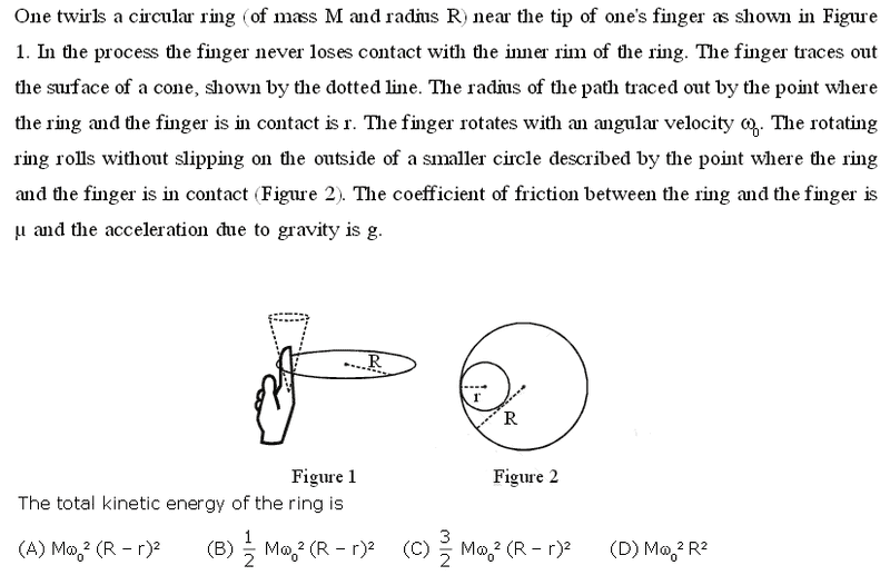

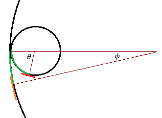

3. The Attempt at a Solution
These are my two observations for this problem .
1) Center of mass of the ring moves in a circle of radius (R-r) about point O . O is the center of the smaller circle in figure 2 .
2) From the geometry , the angular speed of the CM of the ring is equal to the angular speed with which the finger is rotating i.e ω0 .
Now I am not sure how do I calculate the angular speed of the ring about its CM ( which coincides with its center ) .
I would appreciate if someone could help me with the problem .
Thanks

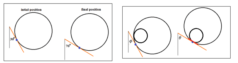

Your observations look good. One way to get to the angular speed of the ring is to consider the geometry shown below
The green arcs have the same length. The red and orange lines are tangents. As the arc of the larger circle lies down along the arc of the smaller circle, think about the change in the angle of the orange tangent. How is that change in angle related to the change in angle of orientation of the larger circle? Can you express this change in terms of the angles θ and ∅?
Likes Vibhor
Sorry . I do not understand what is meant by "lies down along the arc ".
What do you mean by "angle of orientation of the larger circle " ?
Vibhor said:
Sorry . I do not understand what is meant by "lies down along the arc ". What do you mean by "angle of orientation of the larger circle " ?
Sorry, I wasn't clear.
Let the larger ring roll without slipping on the smaller circle. During the rolling, each point of the green arc on the larger circle will make momentary contact with a point of the green arc on the smaller circle until the orange and red tangent lines coincide. Between the start and this moment, find the angle that the larger circle has rotated about its center. Hint: How does this angle compare to the initial angle between the orange and red tangent lines?
Likes Vibhor
##\phi = \theta \frac{r}{R}##
That's the correct relation between the angles ##\phi## and ##\theta##. But what about the angle that the large ring has rotated about its center?
Isn't ##\phi## the angle that the larger ring has rotated about its center ?
No. The angle of rotation of the large ring about its center is related to the change in orientation of the orange tangent.
Likes Vibhor
Sorry , but I think I am not understanding this part .
When the finger is rotated by angle ##\theta## , doesn't the ring rotate about its center by angle ##\phi## ?
How is angle rotated by ring related to change in orientation of orange tangent ?
I am quite confused and finding it hard to visualize .
Please elaborate .

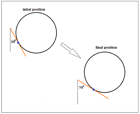

OK, forget the specific problem for a moment. The figure below shows some circle with a tangent line attached at the blue dot. The circle starts in the initial position and then it is translated and rotated to the final position shown. How much has the circle rotated about its center? Assume that the amount of rotation is less than a full rotation.
Likes Vibhor
This is how I think .
The angle initially made by tangent with the vertical is 30 deg , so angle made by normal is 30 deg with the horizontal . Finally normal makes angle 70 deg with horizontal .Angle rotated by normal is 40 deg which is equal to the angle rotated by the circle . Hence angle rotated by circle is 40 deg .
Yes. So going back to the original problem.

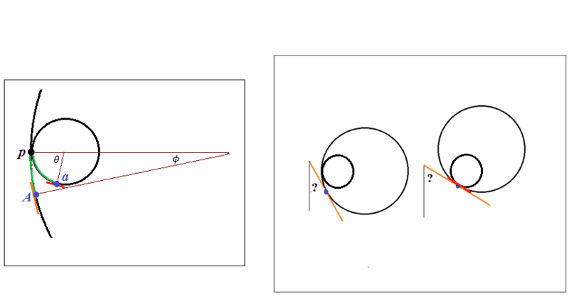

The left figure is as before except I added the blue dots. Point ##p## is the initial point of contact. Later, point ##A## of the large ring will make contact with point ##a## of the small circle. The right figure shows the orientation of the tangent line of the large ring for the initial and final configurations. I have drawn them side by side rather than overlapping them. Can you identify the angles represented by question marks in terms of ##\theta## and ##\phi## of the left figure?
Likes Vibhor
Left ? = ##\phi## and Right ? = ##\theta##
Yes
So angular speed of ring about its center is equal to the angular speed of the finger I.e ω0 ??
No. When the finger rotates through angle ##\theta##, how much does the large ring rotate about its center? Use the same reasoning that led to the 40 degree answer before.
Likes Vibhor
##\theta## - ##\phi##
So when finger makes one full rotation ##\theta## = 360 deg , but what is ##\phi## ?
Yes, the amount of rotation of the large ring is ##\theta - \phi##.
Can you express this solely in terms of ##\theta##? (See your post #5)
To get the rate of rotation of the large ring, divide the angle of rotation of the large ring by time.
[Or, once you express the angle of rotation of the large ring solely in terms of the angle of rotation of the finger, ##\theta##, you can then see how much the large ring rotates when ##\theta## = 360 degrees.]
Likes Vibhor
OK . So the angular speed of the larger ring about its center is ##\omega _0\frac{R-r}{R}## ??
And the linear speed of CM of ring is ##\omega _0(R-r)## ( considering the angular speed of the CM about the center of small circle ) ??
Option A) ??
Option A) ??
I believe that's right.

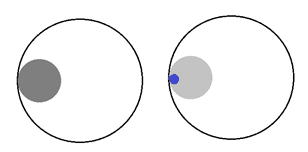

In the left diagram above, you can imagine the grey circle to be a solid disk that doesn't move while the large ring rolls without slipping on the disk. The point of contact is the IAOR for the large ring.
In the right diagram I have added a blue dot that represents the finger. The finger can take the place of the solid disk as long as the finger moves along a circle (circumference of the disk). The large ring doesn't know the difference.
At least that's how I see it.
Likes Vibhor
