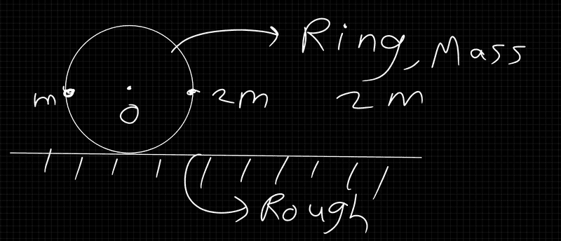

A ring initially at rest begins to roll (pure rolling) on a rough horizontal floor. It has two masses, m and 2m fixed at diametric points, as shown in the figure. If the mass of the ring is 2m, find the:
1. Angular acceleration of the ring
2. Frictional force acting on the ring
3. Normal reaction on the ring
Tau= I alpha ,
v= wr
Honestly, I was very confused looking at the problem. With intuition, it is clear that the ring will roll towards the right. But what direction would friction be acting in? That was my first thought.
However I am unable to figure this out, leaving me stuck here.
My only attempt here was to find the com of the ring, which may be useful somehow.

I humbly request someone to aid me in this problem and explain the mechanics here, thanks in advance. I'm only used to seeing rings roll where com coincides with geometric center.

You have listed relevant equations. How do they apply in this case?

No idea, first off I'm not sure which point I would take torques about, but I say the bottom point would be more sensible as it is eliminates torque of friction

Hint: Where is the axis of rotation? What point is instantaneously at rest while the rest of the assempbly rotates about it?

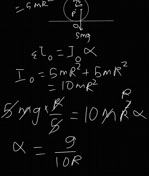

Alright I think I got this.

Before you go there you need to fix part (a).
How do you figure ##I_O=5mR^2+5mR^2##?
Why is the net torque ##5mg\times\dfrac{R}{5}##?
I recommend that you consider as your system the entire assembly of the two particles and the ring together. Then draw the FBD of that and see what you get. That should also help you figure out parts (b) and (c).

Why is it wrong? I tried considering all the particles as my system here. Also I used parallel axes theorem
palaphys said:
Why is it wrong?
I did not say that it is wrong. I asked you to show how you got your answers in more detail. Specifically,
  • where did each ##5mR^2## term come from in your calculation of ##I_O##?
  • why is the net torque about point O equal to ##5mg\times\dfrac{R}{5}##?
This is to make sure you know what you're doing.

Your calculation of the net torque is correct. Your calculation of ##I_O## is not. To find the moment of inertia about the bottom point O, don't cut corners. Find separate expressions for
  • the moment of inertia of ##2m## about that point
  • the moment of inertia of ##m## about that point
  • the moment of inertia of the ring about that point
and add the three terms together.

How is the third point sensible though. I thought Parallel axis theorem was icm+md^2= Io. But cm is not at the center point ont he ring,.
