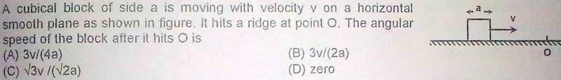

First i thought i could apply conservation of momentum about O
but about O ... mg has a torque ... now what to do ?

hi cupid.callin! :smile:
but not an impulsive torque :wink:
