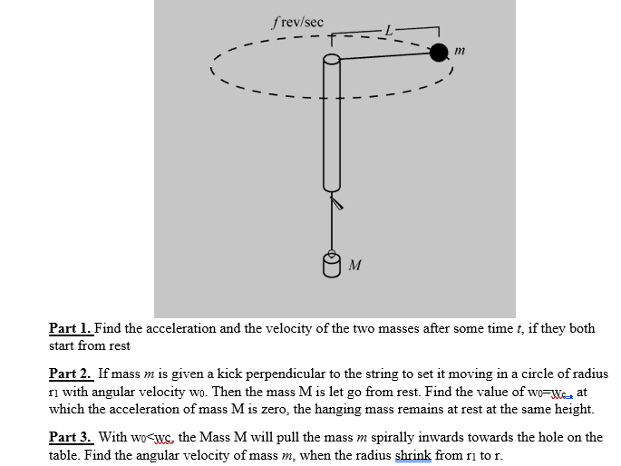

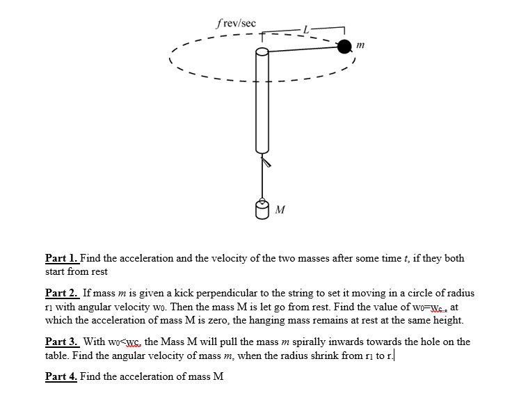

Rotational Mechanics Homework: Equations & Solution for Part 1 Work
The discussion focuses on solving a rotational mechanics homework problem involving energy equations and free body diagrams (FBD). Key equations include the total energy E as the sum of kinetic energy T and potential energy U, with specific expressions for T in both Cartesian and polar coordinates. The potential energy U is defined as -Mgz, and the relationship between z and r is established as z = L - r. The FBD analysis for both the mass on the table and the hanging mass leads to equations for centripetal force and acceleration. The participant seeks confirmation on their approach and calculations for the problem.
PhysicsFuture
E=T+U
T=1/2 mv^2
U=∫F⋅dr
Part 1 Work

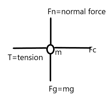

I drew the FBD for both:
for mass on table
Fx
Fc-T=ma
Fc= mrw^2
T=Mg
mrw^2-Mg=ma
a=
rw^2-(Mg)/m
v=rw^2-(Mg)r/m

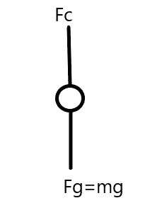

for hanging mass
Fc-Fg=0
Fc=Fg
Fc=Mg
No accleration or velocity
