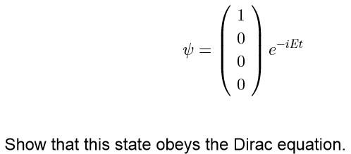

Satisfying Dirac equation, how to make equal to zero.
The discussion focuses on solving the Dirac equation, specifically how to set it equal to zero. The user attempts to manipulate the equation but struggles with the left-hand side, particularly when considering a particle at rest. They realize that if the particle is at rest, the components related to momentum vanish, simplifying the equation. The key relationship between energy and mass is highlighted as E=mc², which leads to the conclusion that the term in the matrix becomes zero. This realization resolves the user's confusion regarding the equation's equality.

Dirac equation: $$(\gamma ^{\mu}\rho_{\mu}-mc)\psi=0$$
If we multiply out the Dirac equation by inserting all it's components we get:

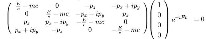

which if I've multiplied it correctly gives $$
\begin{bmatrix}
\frac{E}{c}-mc\\ 0
\\ \rho_{z}
\\ \rho_{x}+i\rho_{y}
\end{bmatrix}e^{-\frac{iEt}{\hbar}}=0$$
I'm not sure how to show the left hand side is equal to zero?
edit just realized that it is at rest so all the ##\rho## components would be zero, but then I still don't see how E/c - mc multiplied by the exponential would give zero?
Any help / ideas would really be appreciated.
If the particle is at rest, what is its relation between energy and mass?
Likes rwooduk
ahhhh E=mc^2 so the term in the matrix would be zero, many thanks!
