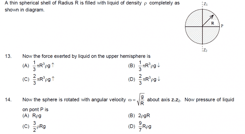

Considering the upper hemispherical liquid part ,the forces acting on it are , force due to the shell and that due to the bottom liquid .
Doing a force balance , force due to upper hemispherical shell = ##\pi R^3ρg - \frac{2}{3}\pi R^3ρg = \frac{1}{3}\pi R^3ρg## (downwards)
Force due to the liquid on upper hemisphere would be ## \frac{1}{3}\pi R^3ρg## (upwards) gives option A) for Q 13 .
For Q 14 , I think rotating the shell doesn't rotate the liquid which means the pressure at point P should remain unaffected i.e option A )
Is that correct ?
Thanks

I guess we assume that the pressure is zero at the point of the liquid at the top of the shell.
I agree with your answer for 13.
I agree with your answer for 14 if the liquid doesn't rotate. But that's not very interesting. I suspect that the problem assumes that the liquid rotates with the shell.

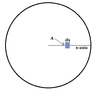

I was thinking of starting from scratch. Take a small element of the rotating fluid as shown below. It has a width dx and the areas of the vertical faces perpendicular to the x-axis are A. Apply F = ma in the x direction to find the change in pressure as you move a distance dx along the x-axis.
## dP = ρω^2x dx ##
##P(x) = \frac{1}{2}ρ ω^2 R^2 + P_{center} ##
##P_{center} = ρgR##
##P(x) = \frac{1}{2}ρ ω^2 R^2 + ρgR ##
##Pressure(P) = \frac{3}{2}ρgR ## i.e option C)
Is this what you are suggesting ?
Vibhor said:
## dP = ρω^2x dx ##
Very good.

Just want to clear few things . The sphere is rotating about an axis coming out of the plane of the page . Right ?
Vibhor said:
Thanks .
No, it says about the axis z1-z2, which makes it vertical in the diagram. With a horizontal axis, your Pcenter=ρgR would be doubtful.

In that case the pressure at the topmost point of the shell on z1-z2 axis would be 0 and that at the bottommost point would be ##2ρgR## ??
Don't you think the dotted lines at the top and bottom of the shell in the figure indicate that Z1-Z2 axis is coming out of the plane of the page ?
