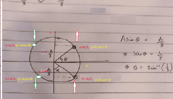

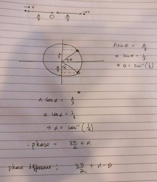

Two particles move parallel to the x-axis about the origin with the same amplitude and frequency. At a certain instant, they are found at a distance A/3 from the origin, on opposite sides of the origin, with their velocities in the same direction. Find the phase difference.
Phasor diagram, with the projection on the y-axis executing shm
What have I done wrong?

You started ok with your circle and phasors, but why introduce angle α ? (There is also another position the phasors could be.)
What is the relationship between θ and α ?
I agree with your calculation for θ and your calculation for α.
I agree with your answer for the phase difference, though I chose the smaller phase angle.
Since there is no indication of which phase is required, you can simply look at your diagram and choose the easiest angle to calculate.
What is the relationship between θ and α ?I agree with your calculation for θ and your calculation for α.
Since they both have the same velocity direction (given in the question) and the both phasor particles move anticlockwise, the positions I chose for the two particles are the only two positions such that their projections are moving in the same direction with equal and opposite distance from the origin

I get this, but why is my solution wrong?

I can't see you taking the velocity functions ##\frac{dx_1 (t)}{dt} = A\omega \cos (\omega t + \delta)## and the same for ##x_2## in account anywhere in the calculation.
I did, that's how I got my phasor diagrams. Since both the particles move anticlockwise, the position I've chosen is the only one where the two projections both have the same direction of velocity as well as equal and opposite displacements from the origin
You should write the problem explicitly as a system of equations for the positions and velocities, and then eliminate the parameters ##A##, ##t## and ##\omega## so that only the phase ##\delta## remains.

I understand that method. I just want to know why what I have done is wrong
Your diagram does not correspond to the particles having the same sign of vx, nor does it correspond to the particles having opposite signs for x.
[EDIT: Your diagram is OK. I mistakenly assumed that the horizontal axis in your phasor diagram corresponded to the x axis. Instead, the x-axis must be the vertical axis (which I should have seen from the fact that your markings of A/3 are on the vertical axis). Sorry for bungling this.]

I just don't understand why people are making it so difficult. It seems to me you've solved it when you get sin θ = 1/3
Yes. I now see what my problem was. I was taking the horizontal axis as being the x-axis in EddiePhys's diagram. I should have looked at it more carefully. It is OK if you take the vertical axis as the x-axis as you have shown in your diagram. I agree with you. Sorry for adding to the confusion.
Oh okay, I got it. Though not mentioned, they were probably expecting the 2nd diagram(green arrows) with the smaller phase angle difference. Thanks a lot! :D
Yes, I agree I'd go for the smaller angle. I just mentioned it because in some situations it's important to be aware that there may be several solutions.
I'm also not sure whether you've seen the symmetry here and that α = π/2 - θ
