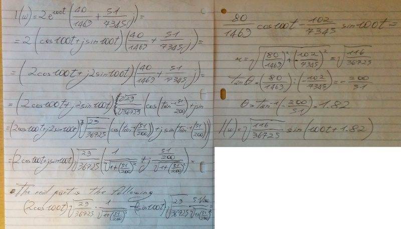

Hello, I have to solve the following problem but I don't know how to find the I(t) from I(ω). I've already found that the total impedance of the circuit should be (1000/29)-j(255/29). Can anyone help me, please? I haven't done Integration and Derivatives. Thank you for your help.

It won't have the same phase as the voltage. The voltage acts as a reference for the phase. The current will have a phase with respect to the voltage. What's the polar form of the current that you calculated?
The current that you found is the phasor form of the current. Convert to time domain by writing it as a cosine function, just as the voltage was written. The angular frequency is the same as the source and you should have the phase from the polar form of the current phasor.
Here is how I managed to calculate I(ω) which I'm not sure it's right. Then, how can I change from I(ω) to I(t)?
You already have I(t). You've called it I(ω) but you should have been calling it I(t) or maybe I(ωt) from the very start.
