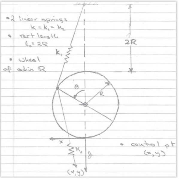

The picture is too tough to draw online, so I've attached a picture of it. The illustrated mechanism shows two springs both with a known spring constant ##k## and rest length of ##2R##. One end of the top spring is fixed above a wheel and the other end is attached to the wheel that may rotate but not move. The other spring also has one end attached to the wheel, while the other end of this spring is at some user-selected distance ##(x,y)##.
I am trying to find the total energy given some location ##(x,y)##.
Spring energy ##k(L-2R)^2/2## where ##L## is the length of the spring.
Energy ##E## is $$E = k(L_1-2R)^2/2+k(L_2-2R)^2/2$$ So all I need to do to express energy as a function of ##x,y## is write ##L_1## and ##L_2## in terms of ##x,y##. To find ##L_1## let's use law of cosines:
$$L_1^2=(3R)^3+R^2-2\cdot3R\cdot R\cos\theta$$ I could find the length of ##L_2## the same way: instead of using ##\theta## I would use ##\pi-\theta##. One side of the triangle has ##L_2##, another has length ##R##, and the last has length ##\sqrt{x^2+y^2}##. But this is where I run into problems. Specifically, how to I express ##\theta## as a function of ##x,y##?
Mathematically, ##\theta## does not depend on ##x,y##. But physically it does, so there must be some physical law I'm not accounting for. Any ideas?
I should say, ##\theta## is the state variable and that ##x,y## are the independent parameters; does that imply it is independent on ##x,y## and I need not bother finding a relation?

Yes, ##x## and ##y## are parameters that are independent of the angle ##\theta## shown in your picture. Express ##L_2## in terms of ##x, y, R## and ##\theta##.
Your expressions for ##E## and ##L_1^2## look correct.

Uh oh. Maybe I'm not interpreting the problem correctly. I thought that values of ##x## and ##y## are first selected and then you are asked to find the PE of the system as a function of the angle ##\theta##, where you could imagine reaching in and rotating the wheel to select any value of ##\theta## that you want (while keeping ##x## and ##y## fixed). In that case, ##\theta## is an independent variable and the potential energy is a function of ##\theta, x## and ##y##: ##U(\theta, x, y)##.
But, maybe you are meant to find the PE only for the equilibrium position of the wheel. In that case, the equilibrium value of ##\theta## can be expressed in terms of ##x## and ##y##. So, the equilibrium potential energy would be a function only of ##x## and ##y##: ##U_{eq}(x, y)##. (But to find the equilibrium value of ##\theta## for chosen ##x## and ##y##, you could use the PE function as defined in the previous paragraph, in principle anyway.)

The expression for L2 doesn't look correct. For example, if you let x = R , y = -R, and θ = π/2, what should you get for L2?

Good catch! So I'm thinking to find ##L_2## we still use law of cosines:
$$L^2=R^2+x^2+(y+R)^2+R\sqrt{x^2+(y+R)^2}\cos(\gamma)$$ where ##\gamma## is the angle opposite of ##L_2##. Since I know everything but ##\gamma##, I'll find it by making its two adjacent sides vectors, and invoking the definition of the dot product. The first vector would be (length doesn't matter) ##\langle\sin\theta,-\cos\theta\rangle## and the second would be ##\langle x,y+R \rangle##. Now use the definition of the dot product:
$$\langle x,y+R \rangle\cdot\langle\sin\theta,-\cos\theta\rangle = \sqrt{x^2+(y+R)^2}\cos\gamma\implies\\
\cos\gamma = \frac{x\sin\theta-(y+R)\cos\theta}{\sqrt{x^2+(y+R)^2}}$$
This implies $$L^2=R^2+x^2+(y+R)^2+R\sqrt{x^2+(y+R)^2}\left[ \frac{x\sin\theta-(y+R)\cos\theta}{\sqrt{x^2+(y+R)^2}} \right]$$
Then I would substitute this into the potential energy equation. Do you agree?
I don't think that's right. (x, y) are the coordinates of one end of the spring. What are the coordinates of the other end of the spring (in terms of R and θ)?
Then use the usual formula for the distance between two points in terms of the coordinates of the points.

This is much easier, huh? :headbang: Ok, so we have ##(x,y)## and ##(R\sin\theta,R(1-\cos\theta))##. Then $$L=\sqrt{(R(1-\cos\theta)-y)^2+(R\sin\theta-x)^2}$$
Do you agree?
Do you agree?
Yes, almost. I think you have a sign error in the y coordinate of ##(R\sin\theta,R(1-\cos\theta))##.
Shoot, dumb algebra mistakes. Ok, so we have ##(x,y)## and ##(R\sin\theta,R(-1-\cos\theta))##. Then $$L=\sqrt{(R(1+\cos\theta)+y)^2+(R\sin\theta-x)^2}$$

That looks good.
Shouldn't the elastic strain energy pass through a minimum at the equilibrium value of ##\theta##?
Yep, so ##dp/d\theta = 0## gives the optimum ##\theta## values to substitute back into ##P## for a surface of equilibria, right?
