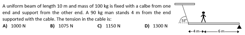

Net Force = 0
Net Torque = 0
3. The Attempt at a Solution
At the support point
, is there a horizontal force component?​

This is irrelevant to the solution of the problem, why do you think it is an issue?
shuoldn't I draw FBD first?
You can do that if you want, but the question you should ask yourself once you have done that is: can I compute the result without knowing the answer to the question you just asked?
I know the message you want to give me .. I would take net torque around the support point so all forces from it will have 0 torque.
But i asked the question because there must be horizontal force produced from there. because there is only single horizontal force genrated from rope. so there must be a balancing force

Yes, you can assume there is sufficient friction at the support to prevent it slipping.

Just to add: Otherwise it will slip and not be in equilibrium.
