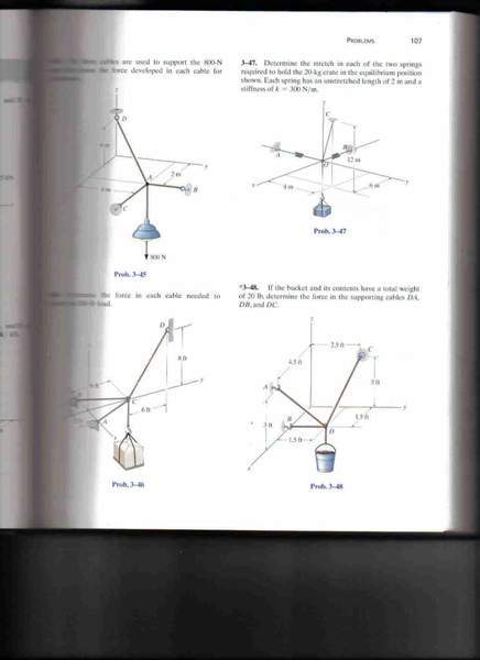

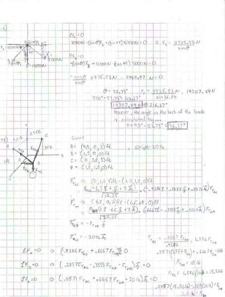

Static's Problem... :(
The problem is 3-48.
Please check if I did it correctly.
The problem is in the pic. file and the solution is attached in another pic. file.
Note*: For the solution. Please ignore the upper problem. The solution to the problem that I came up with is the bottom portion.
Thanks for your help in advance!
