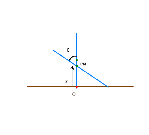

A stick of mass M and length L is held vertically on a frictionless surface. A gentle push at the top causes the rod to fall from this position . Find the speed of its center of mass when it makes an angle θ with vertical .
a) Use force method
b) Use energy method
F=Ma
τ=Iα
First I tried using the Newtons laws of translation and rotation .
1) The forces acting in the vertical direction are Mg and Normal from the floor at the lower end (N) .
$$ Mg - N = Ma_{cm} $$
2) Writing torque equation about CM ,
$$ N\frac{L}{2}sinθ = \frac{ML^2}{12}\ddotθ $$
3) ycm = (L/2)cosθ
So , $$ v_{cm} = -\frac{L}{2}(\dotθsinθ) $$
and , $$ a_{cm} = -\frac{L}{2}[\ddotθsinθ + (\dotθ^2)cosθ] $$
Using the above three equations,I end up with
$$ a_{cm} = \frac{1}{1-3sin^2θ}(-3gsin^2θ - \frac{L}{2}\dotθ^2cosθ ) $$
But I need to find relation between vcm and θ .
I would be grateful if somebody could help me with the problem .

I miss a picture...
If the origin is at the ground just below the CM, the y-axis points upward, and then macm=d2ycm/dt2=N-mg.
Using acm and vcm is confusing, use the derivatives of y, and check the signs.
At the end, use ω2 as variable, function of theta.
ehild

ehild said:
I miss a picture...
Here is the picture
Ok, I have the same picture.
ehild

$$ \frac{(3sin^2θ+1)}{(12sinθ)}\frac{dz}{dθ} + \frac{L}{2}(cosθ) z - g =0 $$
Does this makes sense ?
You miss an L in the first term. Otherwise it is OK :thumbs:

ehild...By applying method of separation of variables ; z =u(θ)v(θ)
v(θ) = C1/(3sin2θ + 1)
u(θ) = (-12gcosθ)/(LC1) + C2
This doesn't give me correct answer ...Is this what you are getting or something else?
One integration constant is enough, you can take C1=1.
It looks correct, although I did not check the constants. So uv=ω2, and ω=0 at θ=0. Find the constant, then calculate ω at θ=pi/2.
ehild

Constant C = 12g/L
ω2 = 12g(1-cosθ)/[L(3sin2θ+1)] .This doesn't seem to be right.
Why ? What has θ=pi/2 to do ?
Sorry, I thought you need the final velocity. Why do you think it is not right?
ehild
So, $$ ω^2 = \frac{12g(1-cosθ)}{L(3sin^2θ+1)} $$ looks alright to you ?

why minus? And you miss a factor of 2. $$ ω =2\sqrt{ \frac{3g(1-cosθ)}{L(3sin^2θ+1)} }$$
and Vcm=-ωsinθ L/2.

Oh ! that was a typo..I meant
$$ v_{cm} = -[\frac{3gL(1-cosθ)(sinθ)}{(3sin^2θ+1)}]^\frac{1}{2} $$
Minus makes perfect sense...
  • #33
$$ v_{cm} = -[\frac{3gL(1-cosθ)(sin^2θ)}{(3sin^2θ+1)}]^\frac{1}{2} $$
sinθ has to be squared if you pull it under the square root. But otherwise it is perfect:thumbs: Have a good rest, you deserve it. :smile:
