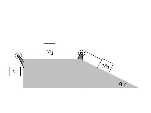

In the figure below, M1=1.00 kg, M2=2.00 kg and M3=4.00 kg. Theta is 30.0°. The pulley and all surfaces are frictionless. Find the tension in the two strings and the direction (entire system to the left/counterclockwise or entire system to the right/clockwise) and magnitude of the acceleration.
Diagram attached.

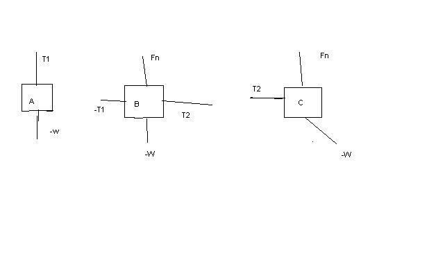

I drew a free-body diagram for each of the blocks and I came up with these equations.
A=T1-W=ma
B=-T1-W+Fn+T2=ma
C=-T2-W+Fn=ma (I rotated it to have the block on a straight surface)
After doing these steps I am completely lost. I think I did my force equations correctly, but if someone can help me with this, step by step, it would be GREATLY appreciated.

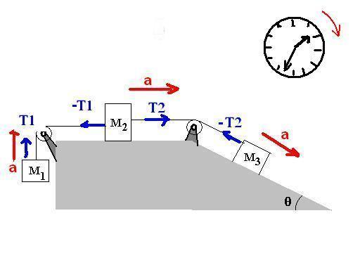

Remember, force is vector quantity. The components add up separately.
You can take this as a one-dimensional problem, considering the motion along the string. The force components parallel to the strings add up to ma, where a is the acceleration in the direction of the string: If A accelerates upward, B will accelerate to the right and C accelerate down the slope.
The normal force components cancel with gravity. You do not need to include them into the equations.
C feels a force component along he slope due to gravity. That is missing from equation C.
ehild

These are your equations from post 1.
A:T1-W1=m1a
B:-T1[STRIKE]-W+Fn[/STRIKE]+T2=m2a
C=-T2[STRIKE]-W+Fn[/STRIKE]+Fslope=m3a
Omit the Fn-W terms.
Do you know what force acts downward along the slope, because of gravity?
ehild
kinetic friction? i thought it would have been mgsin∅
It is not kinetic friction, but it is m3gsin(theta). Substitute the values given for the masses and for theta and write up the equations again with the numbers.

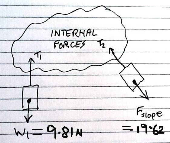

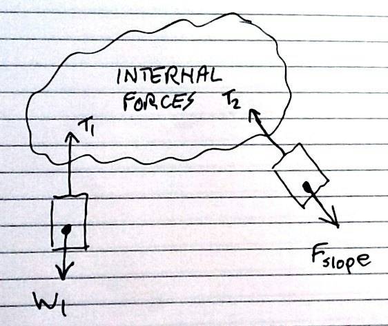

When you have calculated the acceleration a useful double check is to look at the whole system and recognise that T1 and T2 are INTERNAL forces. There are only 2 external forces (W1 and Fslope) and it is the resultant of these 2 forces that cause acceleration of the TOTAL mass. You should get the same acceleration !but this will not give you T1 and T2.
You need the full analysis as outlined by ehild.

As for the direction of acceleration, it is the acceleration of the whole system, along the length of the string instead of x and y direction. The string defines the direction, it is "x" and there is no y. That is what the problem said:
Find the direction (entire system to the left/counterclockwise or entire system to the right/clockwise) and magnitude of the acceleration.
So is it clockwise or anticlockwise?
ehild

If you look at the external forces you see the resultant = 9.81N
The total mass is 7kg therefore acceleration = F/m = 9.81/7 = 1.4ms^-2
Now you know the acceleration you can apply F = ma to each mass to double check that T1 = 11.2N and T2 = 14.02N (I would round this off to 14.0N)
