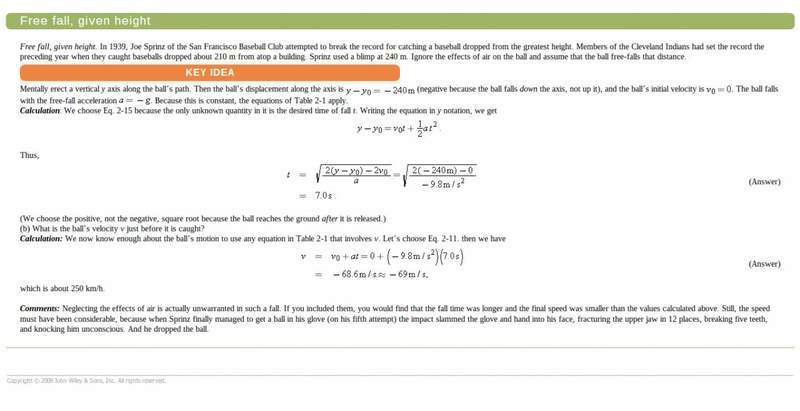

There is an image but I will reiterate my problem.
The writer is solving for t. Okay, easy enough.
y-y0 = v0 t + 1/2 a t^2
Textbook says
t = sqrt( (2(y-y0) - 2 v0) / a )
Shouldn't it be
t = sqrt( (2(y-y0) - 2 v0 t) / a )
Let's take it slow.
Multiply both sides by two.
2(y-y0) = 2 v0 t + a t^2
Bring (2 v0 t) to left side.
2(y-y0) - 2 v0 t = a t^2
Divide both sides by a.
(2(y-y0) - 2 v0 t) / a = t^2
Sqrt both sides.

dimensionally you can see theirs is wrong
Writing in standard form:
y-y0 = v0 t + 1/2 a t^2 becomes
(1/2) a t^2 + v0 t - (y-y0) = 0
so that for the general quadratic in t, A t^2 + B t + C = 0,
A = a/2
B = v0
C = -(y - y0) = (y0 - y)
and the roots are
t = [itex]\frac{-v_{0} \pm \sqrt{v^{2}_{0}-4(a/2)(y_{0}-y)}}{a}[/itex]
With your algebra:
you wind up with 't' on both sides of the equation, which isn't conducive to obtaining a solution for t without iterating.
My 'guess' is v0 = 0 somewhere in the problem statement.
The textbook (or solution manual) write is completely wrong with his t = ...
He/she should have written y-y0 = 1/2 a t^2 first and then proceeded to t = ... (without the -2v0).

The page is attached as an image.

The book is wrong. They already said v0 = 0 so they should have removed it from the equation.
Your equation
is "right", but it's only useful in this problem because v0 = 0 and therefore to v0t = 0.
If v0 is not 0, you have to solve the quadratic equation as Steamking said.

Alright I really like SteamKing's answer. Clearly states how the t went missing. Thanks. Really helps
Yeah the book doubly messed up. First, as you show the answer is flat out wrong and second it doesn't even make sense to try to do what they did. Doing what they did would trap you with a t on both sides which is useless unless you lucked out to have v0=0. They forget to bring the t over though which makes it look like they actually used a method that would be some general form to solve things. It really makes no sense and it doesn't even give the right dimensions that even work out.
Either they should have presented it full out in general with the whole -b+/srt( )/blah etc. formula or just plugged in 0 for v0 to start and then just did d=1/2 * a * t^2 and then get t= sqrt(2d/a)
Man that is really messed up. It's hard to believe that is published in a book like that.
