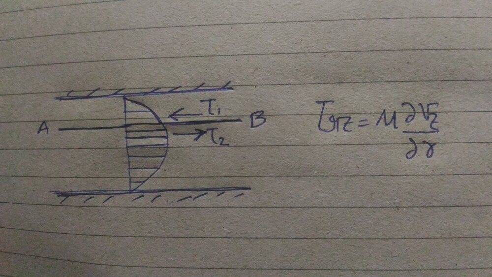

In a laminar flow in pipe, we have a parabolic velocity profile. If we have to determine stress at a plane let's say AB which is at a location r, we will differentiate the velocity profile to determine the velocity gradient,then we will put it in Newton law of viscosity to determine stress at that point.
If we see the stress at above and below the plane , we see two stresses acting in opposite direction.
So is the stress obtained from Newton law via velocity gradient which was obtained from differentiation of velocity profile is equal to the net of the stress we have above and below the plane which in infinitesimal in thickness.

So is the stress obtained from Newton law via velocity gradient which was obtained from differentiation of velocity profile is equal to the net of the stress we have above and below the plane which in infinitesimal in thickness.View attachment 265612
The shear stress components of the stress tensor are the same on both sides of the plane, and determined by Newton's law of viscosity. The traction vectors on the two sides of the plane constitute and action-reaction pair, and are equal in magnitude and opposite in direction. So, of course, the net force on the (massless) plane is zero.

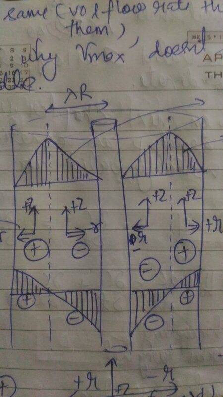

In a double pipe, talking about flow in the annulus region we get stress profile something like this. What does the negative and positive in stress profile means?
In the inner region, the fluid at ##r^-## is pulling backwards on the fluid at ##r^+##. In the outer region, the fluid at ##r^-## is pulling forwards on the fluid at ##r^+##.

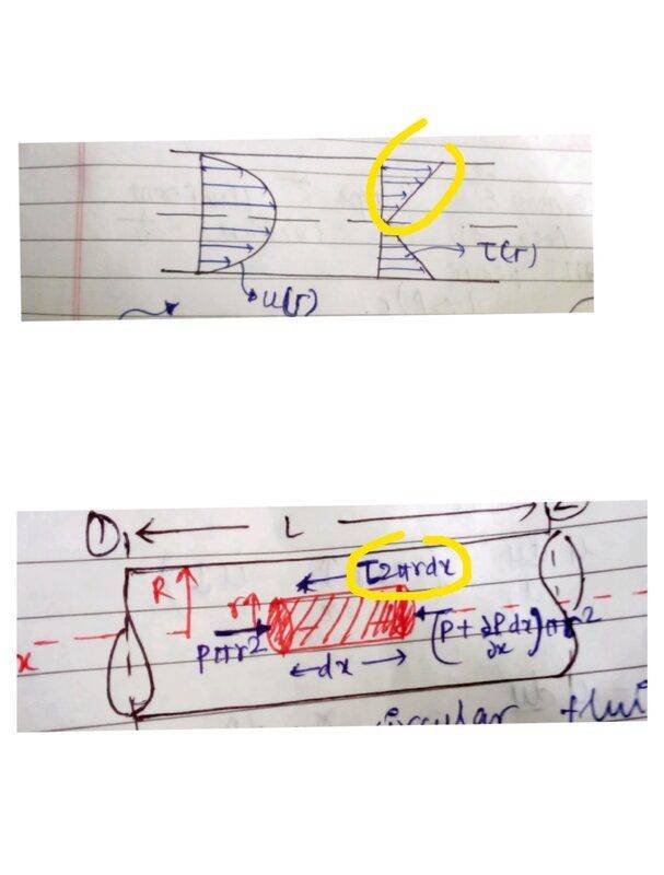

Hello Sir Chet , Sorry for being very late to this , it was due to some personal reasons in this pandemic.
Here I will continue further,
In this picture , the stress is acting backward as seen on the element, but stress profile says its positive . I'm a bit confused in understanding the meaning of stress profile, Can you please elaborate your last statement a bit more ,also in the same fashion as your last statement , please do the same for this stress profile.
There are two sign conventions that are used for the stress tensor, and, thus, for determining the stress profile. One is to treat tensile stresses as positive and compressive stresses as negative. The other is to treat compressive stresses as positive and tensile stresses as negative. The former is used most often, but, apparently, in the development you are working with, the latter is used (Transport Phenomena by Bird et al??). In the convention you are using, when applying the Cauchy stress relationship, you draw a unit normal from ##r^-## to ##r^+##, dot this with the stress tensor, and this gives you the stress vector (both normal- and shear stress) exerted by the fluid at ##r^-## on the fluid at ##r^+##. If you had used the other convention, when you dotted the unit normal with the stress tensor, it would have given you the stress vector exerted by the fluid at ##r^+## on the fluid at ##r^-##, and the shear stress would have been in the negative x direction. I hope this makes some kind of sense. If you are using Bird et al, it is important that you read the Appendix on dyadic tensor notation for 2nd order tensors (like the stress tensor), which can explain this in more detail. I hope that this makes some kind of sense to you.
