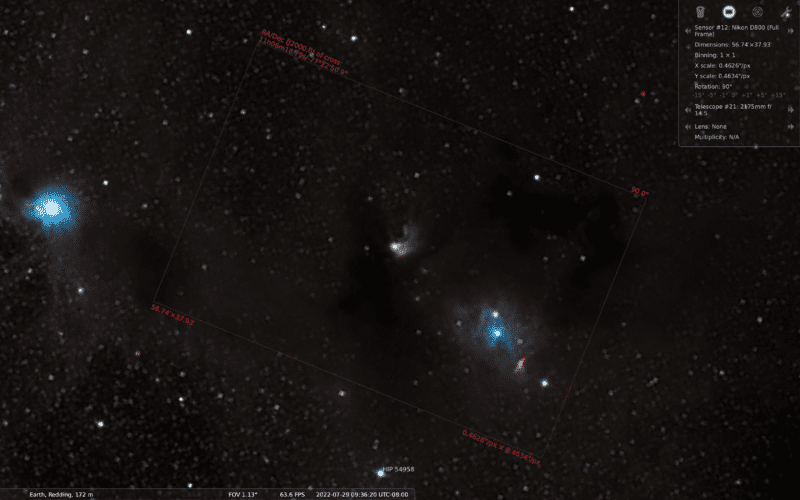

For what it's worth, I have a backyard telescope and astronomy camera. Even when it's a balmy 21 deg C (70 deg F) outside I still cool my camera's sensor down to -10 deg C (14 deg F) using a Peltier junction device inside the camera.
I don't cool down the whole telescope or even the whole camera. 'Just the camera's sensor. That's all that's needed to reduce thermal noise. (Of course, I'm imaging using the visible spectrum. I would have to cool more things down if I was shooting in the deep infrared.)
The camera's sensor relies on some active electronic trickery to produce a potential energy well for each pixel. Photons of sufficient energy can strike the camera's sensor and knock an electron into the well.
But sometimes, due to the thermal vibrations of atoms that make up the sensor's electronics itself, electrons can "accidentally" get bounced into the well. This gets interpreted as a photon detection, but it really isn't. It's just thermal noise. This is sort of analogous to how a violently boiling pot of water might splash liquid water outside the pot, even though the water droplet splashes didn't leave the pot by being converted to steam.
