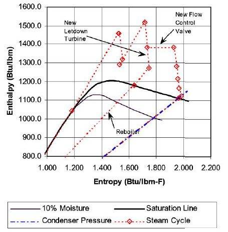

Below is a Mollier diagram, a plot of enthalpy versus entropy for water. The saturation line is indicated. The superheated vapor region is above and to the upper right of the saturation line on this diagram.
