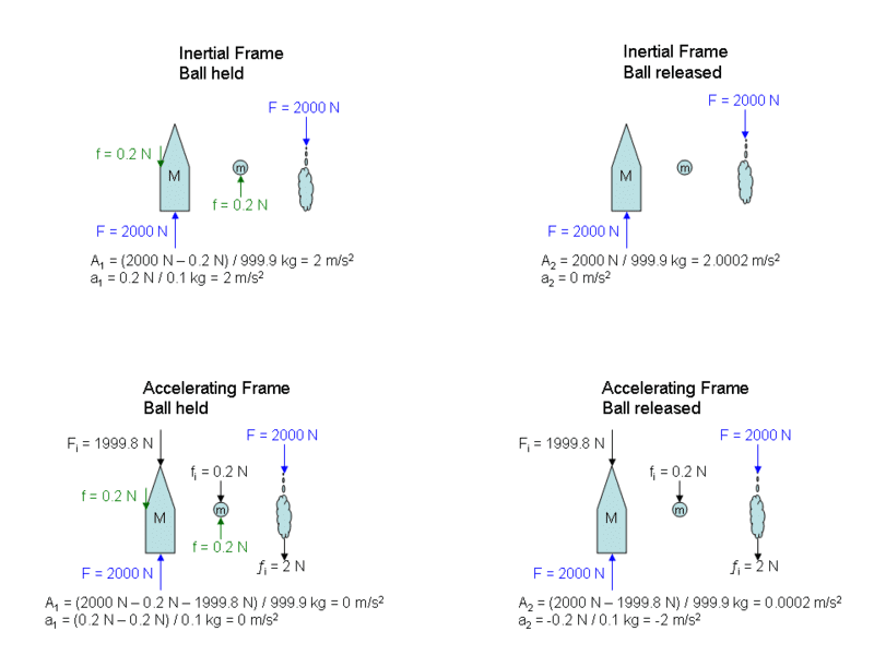

OK, I see that I am going to have to justify my statements a little better. I apologize for thinking my points were obvious. I was obviously not writing as clearly as I thought I was.
The question I am addressing is: "How are Newton's laws violated/modified in an accelerated reference frame?" I will address only v<<c so that we don't need to worry about relativistic effects and we will stick with the rocket in deep-space scenario so that we don't need to worry about gravity, friction, air resistance or any other confounding factors.
First, let's start in the inertial frame where the rocket is initially at rest at the origin with the engines off. This will be the unprimed frame and all unprimed coordinates will reference this frame.
At time t=0 the rocket turns on generating a steady 2000 N of thrust in the x direction. The rocket masses 1000 kg. The thrust is the only force acting on the rocket so, by Newton's 2nd law, the acceleration is 2 m/s². In SI units, the equations of motion for the rocket are therefore:
r(t)=(t²,0,0)
vr(t)=(2t,0,0)
ar(t)=(2,0,0)
for t>0.
At t=1 a ball is released in the cockpit. After release there is no force acting on the ball, so by Newton's 1st law, the acceleration is 0. In SI units, the equations of motion for the ball are therefore:
b(t)=(2t+1,0,0)
vb(t)=(2,0,0)
ab(t)=(0,0,0)
for t>1.
So far we have considered Newton's 2nd and 1st law, but not the 3rd law. The only force considered thus far is the thrust. There is a thrust force which is acting on the rocket exhaust which is equal-and-opposite to the thrust force acting on the rocket. This force accelerates the exhaust and satisfies Newton's 3rd law.
Now we will consider the situation in the primed reference frame in which the rocket is at rest at the origin for t>0, i.e. this frame is accelerating at a rate of 2 m/s² in the positive x direction wrt the inertial frame. The transformation equations are:
t'=t
x'=x-t²
y'=y
z'=z
By transforming we obtain the equations of motion for the rocket in the primed frame:
r'(t')=(0,0,0)
vr'(t')=(0,0,0)
ar'(t')=(0,0,0)
t'>0.
Since there is a non-zero net force acting on the rocket and since the acceleration is zero f≠ma, a clear violation of Newton's 1st and 2nd laws.
Similarly, by transforming we obtain the equations of motion for the ball in the primed frame are:
b'(t')=(-t²+2t+1,0,0)
vb'(t')=(-2t+2,0,0)
ab'(t')=(-2,0,0)
t'>1.
Since there is no force acting on the ball and since the acceleration is non-zero f≠ma, a clear violation of Newton's 1st and 2nd laws.
However, we can easily "fix" the first and second laws simply by introducing an inertial force (-2M,0,0) where M is the mass of the body on which the force is acting. So, for the rocket, this inertial force exactly balances the thrust such that the net force is zero which explains the acceleration of zero. For the ball, this inertial force is the only force acting on it so there is a non-zero net force which explains the non-zero acceleration. Thus, with this modification Newton's 1st and 2nd laws are now satisfied.
Now, let's consider Newton's 3rd law in the accelerated reference frame. Again, the thrust force on the rocket is equal and opposite to the thrust force on the exhaust, forming a 3rd law pair. That leaves only the inertial forces. However, all of the inertial forces act in the same direction, so they do not form 3rd law pairs. The inertial forces violate the 3rd law because there are no equal and opposite inertial forces.
I hope this clearly explains my above statements, because I really would have a hard time being more explicit or concrete.

I really don't know what more I can do here. I have given a very clear and concrete example fully worked out. I have shown my reasoning step-by-step and backed up my claims with explicit demonstrations. Please do the math yourself. Work a few of these problems and see that the inertial forces do not follow Newton's 3rd law. If you cannot see that from what I have already presented then I am sure that further write-ups on my part will not be helpful. There is really no substitute for getting down into the details and going through the work yourself.

Show your work and justify your claim that it is equivalent.
belliott4488 said:
Do you in fact believe that Newton's 3rd law is violated in the approximation of a constant gravitational field that is typically invoked for motion on the Earth's surface? If so, then at least you're consistent, although rather unconventional, since that approximation is often used in the presentation of Newton's Laws for the first time in introductory Physics.
In Newtonian physics gravity is a real force with two bodies interacting. It satisfies the 3rd law, and I have no problem with the approximation to a uniform field.
The fact that the uniform approximation has the same form as the inertial force is irrelevant here. The two situations are not equivalent wrt the 3rd law because the gravitational force is due to the interaction with another body and the inertial force is not.

OK, belliott. I am willing to engage in a discussion about GR and the equivalence principle, but first I want you to address directly the following:
In my example I purposfully set up a scenario without gravitation so that there would be no confusion about if a given force was real or inertial. So, in the context of my example (i.e. flat spacetime, no gravity) I have performed an analysis demonstrating a clear violation of Newton's 3rd law in an accelerated reference frame. You are claiming that there is no such violation, so where did I make my error? Can you demonstrate that Newton's 3rd law is, in fact, satisfied in my scenario?

Hi belliott, here is my work. I have attached free-body diagrams for all four parts of this problem. All forces are indicated on the diagrams and the accelerations are worked out for the rocket and the ball. Note in particular that I have highlighted the blue 3rd law pair for the thrust and the green third law pair for the contact force. Note also that none of the inertial forces in black are part of a 3rd law pair, i.e. they do not satisfy the 3rd law.
Below are the resulting equations of motion where capital X indicates the position of the rocket, lower-case x indicates the position of the ball, subscript 1 indicates when the ball is held, subscript 2 indicates when the ball is released, unprimed is the inertial coordinate system, primed is the accelerated coordinate system with transformation equation between the two x' = x - t² and inertial forces of -2m on every mass in the accelerated frame.
The equations of motion for the inertial frame while the ball is held (upper left) are:
[tex]\begin{array}{l}<br /> X_1=t^2 \\<br /> x_1=t^2<br /> \end{array}[/tex]
The equations of motion for the accelerated frame while the ball is held (lower left) are:
[tex]\begin{array}{l}<br /> X_1'=0=X_1-t^2 \\<br /> x_1'=0=x_1-t^2<br /> \end{array}[/tex]As you can see, these equations transform correctly, indicating agreement between the frames. As you can also see, the inertial forces were required in order to achieve this agreement.
Evaluating the above expressions at t=1 for the initial conditions of the next part gives:
[tex]\begin{array}{l}<br /> X_1(1)=x_1(1)=1 \\<br /> V_1(1)=v_1(1)=2<br /> \end{array}[/tex]
[tex]\begin{array}{l}<br /> X_1'(1)=x_1'(1)=0 \\<br /> V_1'(1)=v_1'(1)=0<br /> \end{array}[/tex]
The equations of motion for the inertial frame while the ball is dropped (upper right) are:
[tex]\begin{array}{l}<br /> X_2=1.0001 t^2-0.0002 t+0.0001 \\<br /> x_2=2. t-1.<br /> \end{array}[/tex]
The equations of motion for the accelerated frame while the ball is dropped (lower right) are:[tex]\begin{array}{l}<br /> X_2'=0.0001 t^2-0.0002 t+0.0001=X_2-t^2 \\<br /> x_2'=-t^2+2. t-1.=x_2-t^2<br /> \end{array}[/tex]As you can see, these equations again transform correctly, indicating agreement between the frames. As you can also see, the inertial forces were again required in order to achieve this agreement.
Bottom line: in the accelerating frame the inertial forces do not follow Newton's 3rd law, as shown in the free-body diagrams, but are required in order to satisfy Newton's 1st and 2nd laws and to obtain the correct equations for motion. In order to satisfy Newton's 1st and 2nd laws the 3rd law is violated. I didn't look at your posts in detail, but from my cursory reading nothing even appeared to address the 3rd law nor rebut my claims that it is violated.

OK, there are several errors in this analysis. First and most importantly, you left out the thrust force (2000 N) acting on the rocket. Second, you left out the inertial force of the rocket (-1999.8 N). These two forces are sufficient to account for the acceleration and obtain agreement between the two frames. By arbitrarily adding another 0.2 N force on the rocket you wind up with disagreement between the frames since the delta acceleration in the non-inertial frame would be twice the delta in the inertial frame.

so
[tex]x'_b(t) = (v_{b0}-v_{r0})t - \frac{1}{2}at^2 = h(t)[/tex]
In other words, by invoking Newton's Laws in his accelerated frame, the spaceman predicts exactly the same answer that we do in our inertial frame.
This is fine, your frame is accelerating at a different rate than mine, but everything works out OK.
However, you never addressed the 3rd law question here. Where is the 3rd law pair for the -0.20002 N "inertial force in the 'downward' direction" on the ball? You have an inertial force on the rocket of -2000 N which exactly balances the thrust of 2000 N, but that force is neither equal nor opposite. Again, from your own work, it is clear that in order to get Newton's 1st and 2nd laws to work in the accelerated frame you must postulate inertial forces which violate the 3rd law.

If it is not necessary for a force to have an equal and opposite pair then Newton's 3rd law is not a law.
newTonn said:
Still if it is so necessary,i can say there is a fictious equal and opposite pair for it ,by using the same logic.
No, you cannot, as I have demonstrated twice now. Inertial forces violate Newton's 3rd law. You are welcome to try to demonstrate otherwise, but handwaving like this is insufficient.
