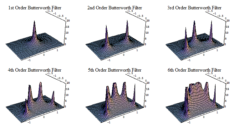

FactChecker said:
3) The location in the complex plane of the poles of rational functions are used to study the response of a system to different frequencies.
That is one of my favorite applications of complex numbers -- mapping transfer functions of systems to work with their stability. Instead of just looking at a 2-D plot of frequency response, you can see so much more in the 3-D complex plot...
http://www.crbond.com/images/filtarry.gif
EDIT -- There's a great plot at the Maxim IC website in an app note -- I'm looking to see if I can find it. The first time I saw it, I realized that I'd been missing something important... :smile:
